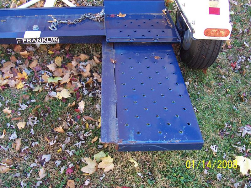

Most of the time the rack that actually cradles the tires is not too narrow but the ramps are too narrow. I bought a new Mastercraft and had them weld a piece to the inside track ramps. They narrowed the ramps by 8 inches total with angle iron. Works fine now. tow dolly 001.jpg
