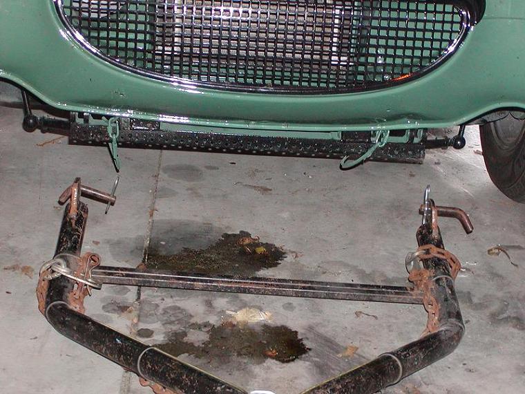

Just took some pictures on the setup here. Still have some over spray to paint. lol

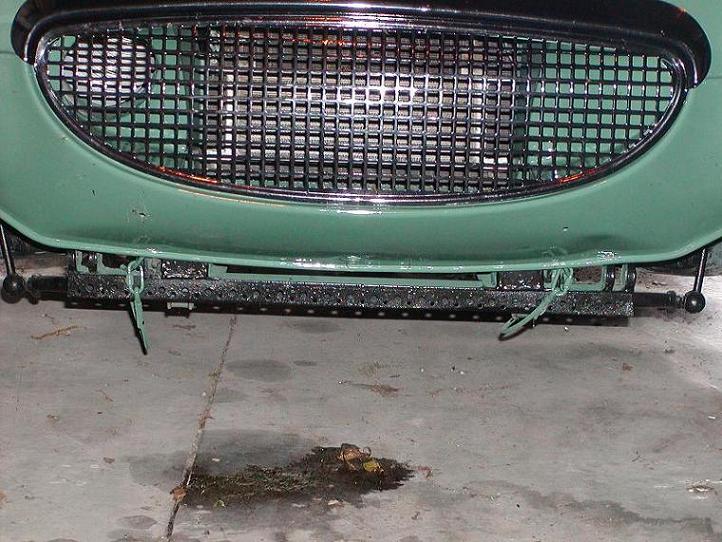

tow bar for a VW. 1" x2" channel bolted across the front with tabs attached for the bar pins. No tilting the front end with the tow bar attached.

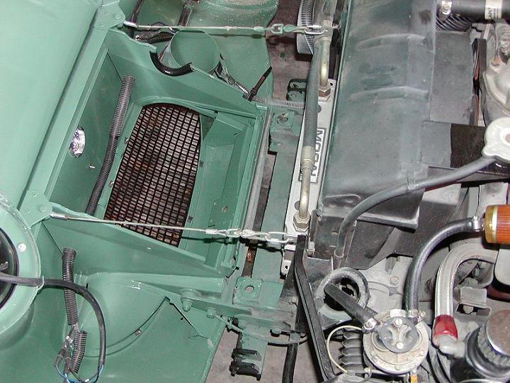

leecreek
And one from the top side.
2091351
The brackets were bolted on using the 'Bumper' holes in the front extensions, then the bar was welded to the brackets.
Completely removeable!! :thumbsup:

Lee, that looks perfect! Can you pull your car without disconnecting the driveshaft? I know that's counter to the advice I've been given and I do want to know if it's possible without causing harm.
Thanks, Rut
