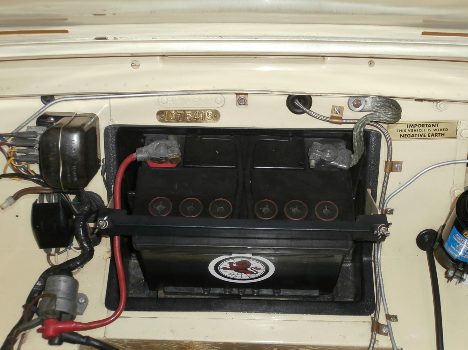

6TTR3A
To me, orientation and configuration are the important factors. I started out with the aftermarket battery box.
Trimmed the back lip so the body number plate is visible. I wanted the posts at the back corners with the
negative post to the left. I wanted the water access holes as far away from the back as possible. I got a
bonus with this battery - The access holes are sealed, and a breather pipe is at the side of the battery pointing
down into the battery box. On the unlikely chance of a boil-over, the acid goes into the battery box instead
of on the paint. In order to get everything I wanted, I had to settle for a group 24.

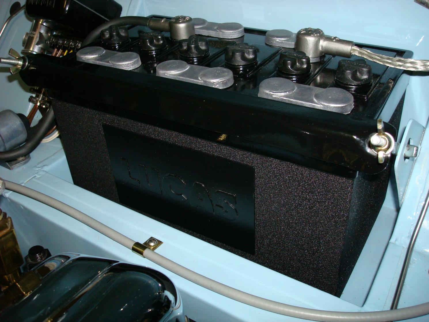

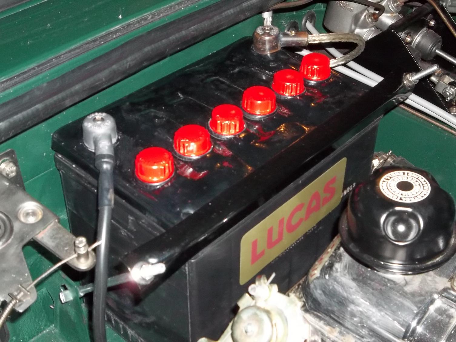

I just got a new battery for my TR4 two weeks ago. The restoration is almost complete and it was time to start the engine for the first time.
I have never been to this store before, but I got a group 24 EXIDE battery from Batteries Plus Bulbs for $71 including 6% tax and after taking the core return off the cost.
I specifically wanted a battery with a totally flat top since I got one of those fake battery tar toppers from https://www.tartopper.com and this battery was one of the ones that fit the bill. I believe the Topper cost $20. Another battery that would have fit the bill was a NAPA.
I used a wood plane to remove the modern style mounting tabs on the sides of the battery near the bottom, took the plastic lifting strap off and did the same with the strap mounting tabs. With the topper on it looks exactly like a period tar top battery and it beats the $300 cost of a reproduction tar top battery.
I was originally going to get a group 27 battery, but the tar toppers only come in group 24 size. The fake tar topper caps don't come in black like the original Lucas batteries supposedly had so I went with red to match the cars seat color.

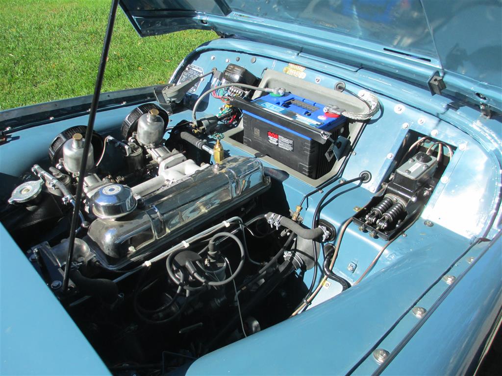

So many choices... I don't expect to fool anyone who is really paying attention but here is my Wal*Mart battery sans original labels and with a set of caps substituted for the 3-hole bar-type caps it came with:
