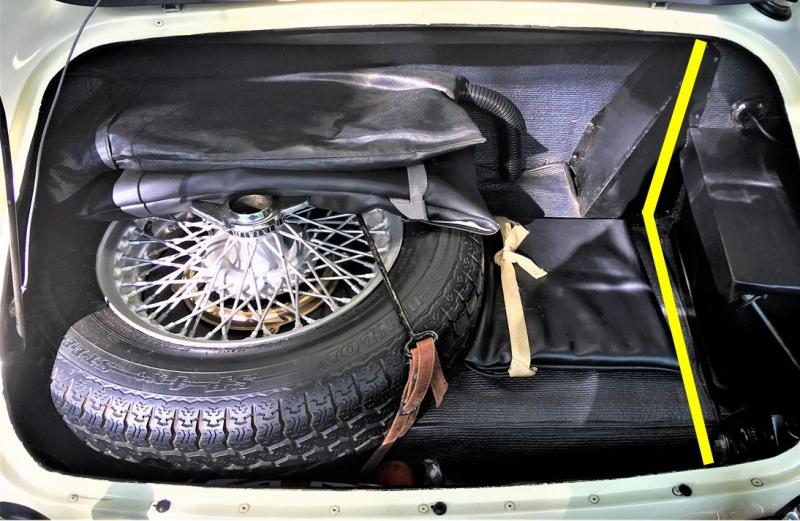

On my BT7, the trunk area is not really sealed. There are openings on both sides of the rear bulkhead that would acts as a vent from the trunk to the rear seat area. I was never sure why they left the gap there but maybe it was to vent the trunk.
Rob,
Yes, I forgot about those openings and never saw a functional purpose for them ... other then some assemblo or construction reason. I have them on my BJ8 so they are probably present in all big Healeys. Assuming that the amount of battery vapor is small, these openings could be sufficient to allow the evaporation and clearing of any battery moisture.
