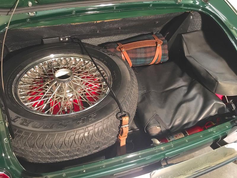

I have a version of this: https://mossmotors.com/cover-battery?assoc=83640. It's not very sturdy, but mine has lasted >20 years. Also, the non-grounded terminal can be covered with tape or a plastic cover.

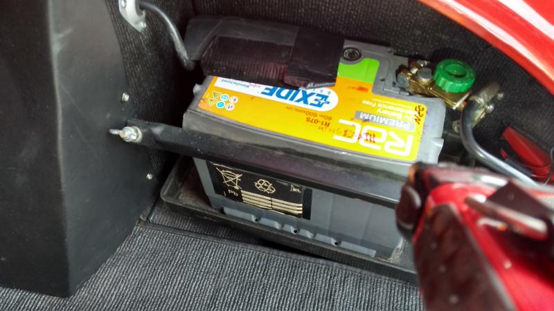

I cut a rectangular piece of old tire inner tube about 4" x 3" and stuck with gaffer tape over the positive terminal. When I need to charge the battery i just flip it over. I also have a cut out on the negative post which I turn off whenever I park the car.
