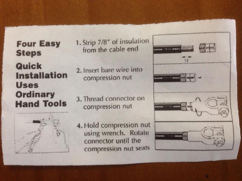

Found a neat product. Had to replace the battery in one of my vehicles...an Optima that lasted 10yrs, 5mos. When tightening the positive clamp it broke. Replacing the cable was going to be a pain. Couldn't reach the starter from the top. I never liked the look of those two bolt replacement clamps so I decided to buy a Fastronix Solutions battery compression end. What a slick product. A little pricey ($13.99 Amazon), but super simple to install, it really holds tightly, and gives a very clean look.
