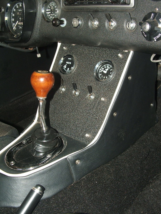

The caveat to my answer is: I'm less interested in listening to a sound system than I am listening to the engine and other audio "clues" coming from the cars. Our MGB is an early car (steel dash) and I fabricated a center console in place of the single speaker under-dash. Concession to sound system is as described above, a "modern" Panasonic AM/FM/CD player with small speakers.

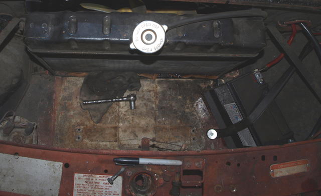

Here is where I put mine. AGM battery out of my 1984 Goldwing.
BM Part #: YTX24HL-BS
Voltage: 12 Volt
Capacity: 21 Ah
Type: AGM
Length: 8.13"
Width: 3.44"
Height: 6.38"
Cold Cranking Amps: 350 CCA
Shipping Weight: 18.00Lbs

Now thats an idea I have NOT seen before....I presume since its only 18 pounds it doesn't adversely impact that balance of the car being all the way up at the bumper. Have you experienced any downsides to using a battery with that low of an AH rating? The 350CCA will be more than enough to spin the motor but if it doesn't fire up immediately is there enough for several tries?
I have seen where many use the Miata battery. Many of those are rated the same or slightly higher. As my car starts very well, I have not had any problems at all so far. Had it in there about a year now.
