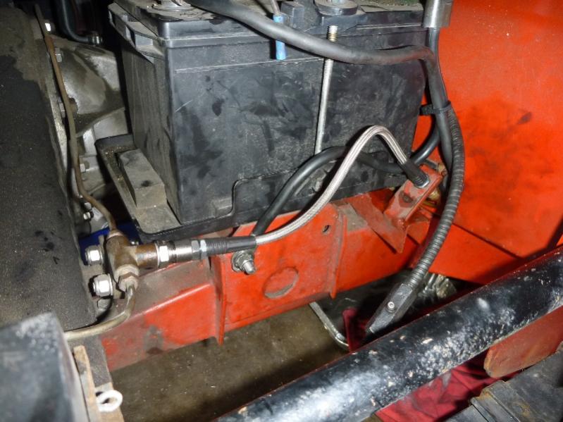

Guy - Your envisioned single-battery setup is the one everyone does for the two-seaters.
At an auto parts store, I bought a plastic tray and adjustable hold-down with j-bolts, which I bolted to the passenger-side battery support. My battery is smaller than the tray, so I mounted a small wood block in the tray to keep the battery from moving.

I moved the fuel pump to the RH side, sitting above the hot exhaust seemed like a poor choice.
I did the same thing as Steve but used a battery with side terminals which created clearance under the lid and made it easier to route the cables.
