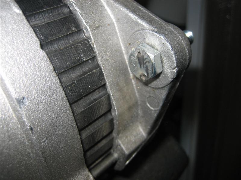

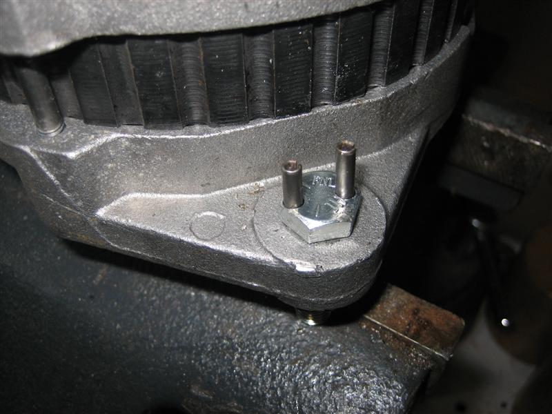

When I installed my GM alternator I found it difficult ti get a wrench on the bottom bolt so I did this. I drilled two holes through the head and into the case then installed spring pins and cut them flush.
Now it is easy to adjust the belt tension.
