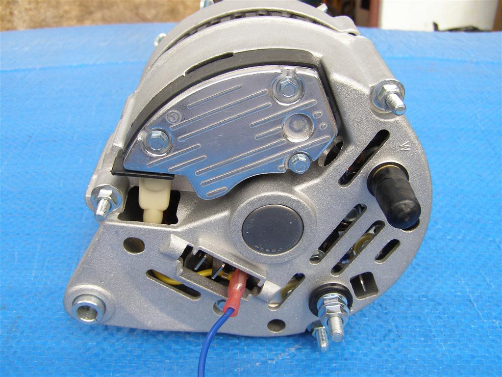

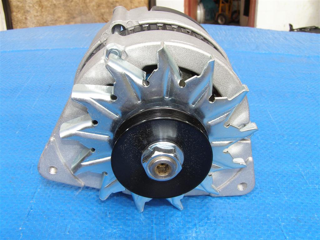

I bought a 95 amp bolt on unit that was exactly the same as the unit on my TR6 and it works perfectly. I just used the different terminals to wire it in with no cutting or clipping of the harness.

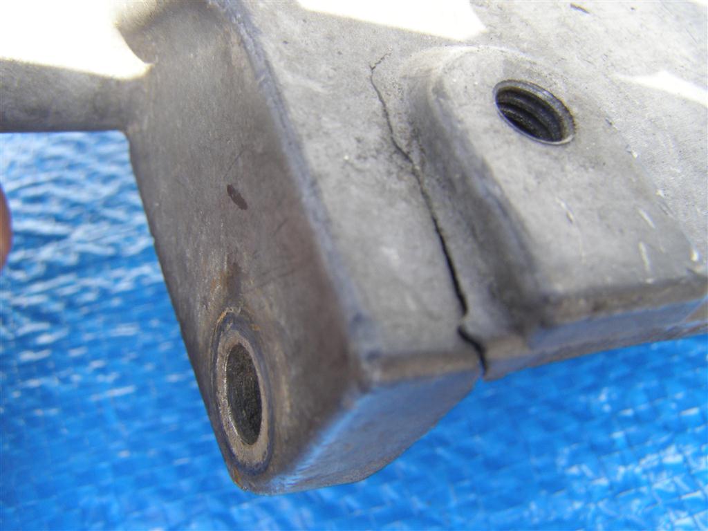

And check the mounting bracket. Mine was cracked.
This was the alternator source: Brosky TR6/TR8 95 Amp Alternator
You may have to Google them for the latest ebay listings.
