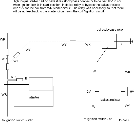

Ballast resistor bypass circuit.jpgI used this diagram to wire a relay into my TR8's high torque starter circuit. Hope this helps.

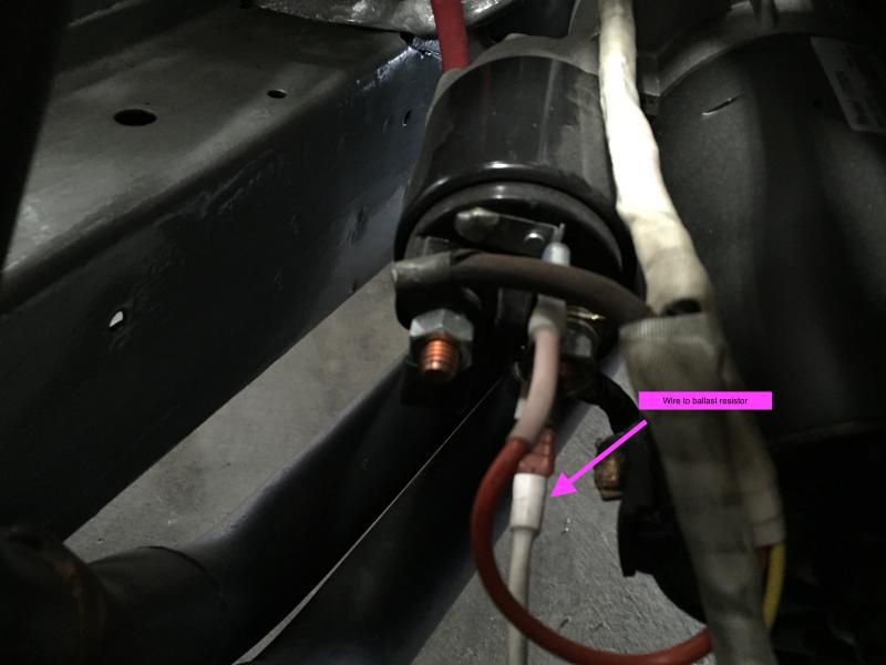

Here is how mine is wired, had to add a lug to the side that is energized when the starter is engaged for the wire to the ballast resistor.
So that is my picture that Don posted. Here is one with the wire to the ballast resistor labeled. I had to add a connection for that wire, I took a ring terminal and a male spade terminal, connected them, and installed the ring terminal under the connection that comes active when the starter is energized. The reason for that connection is that it provides full power to the coil during startup. Hope this helps!
Rick -- was that relay a special one, or just a generic 12V?
