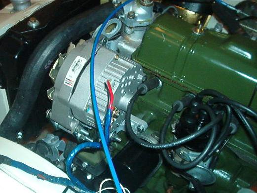

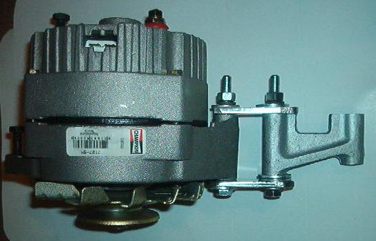

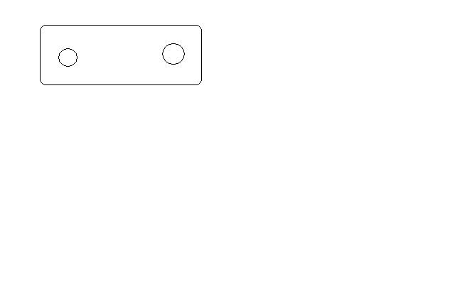

When I did mine (1500 Delco) I mounted it right side up, and made two brackets that looked like this. I then
JPSmit
I then mounted one on each end of this
JPSmit
and the other ends to this - shimming them parallel with washers.
JPSmit
I then tightened up the top as normal - and managed to make my original bracket from water pump to bolt fit - if this doesn't make sense I can post pics tomorrow.
BTW I made my brackets out of the cut offs from the chrome bracket I bought to hold the top in place before I realized I didn't need it.

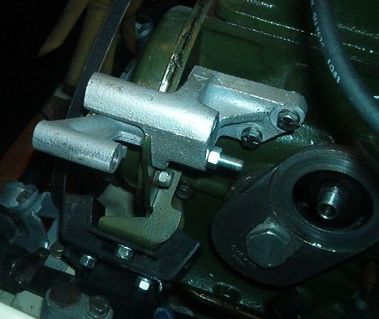

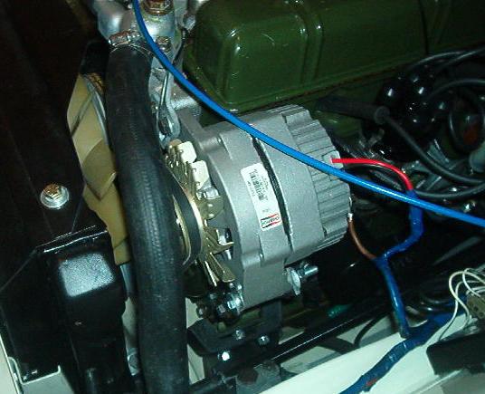

OK just looked and found the pictures - here hope it makes sense

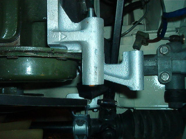

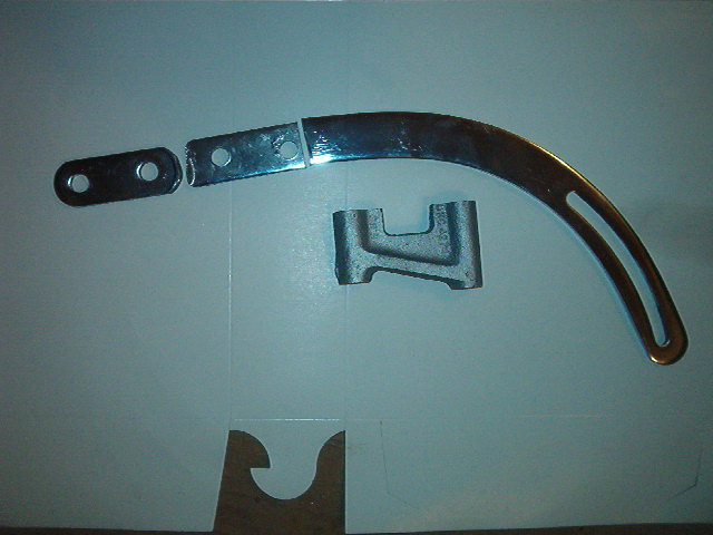

JP,
In that first photo.
There is the chrome bracket and under that there is a cast iron thing.
Where did that cast iron thing come from?
Cheers
PS Here's the broken bolt in the lug hole:
JPSmit
bigjones said:
JP,
Cheers
it came with the car. :whistle:

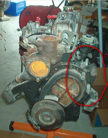

seriously, I THINK it was part of the bracket for the air pump before it was removed. I seem to recall it being attached to the bolts that attach the timing chain cover to the metal backing plate - it was behind that. Sorry I can't be more help than that. just went into the files again -you can see it here
