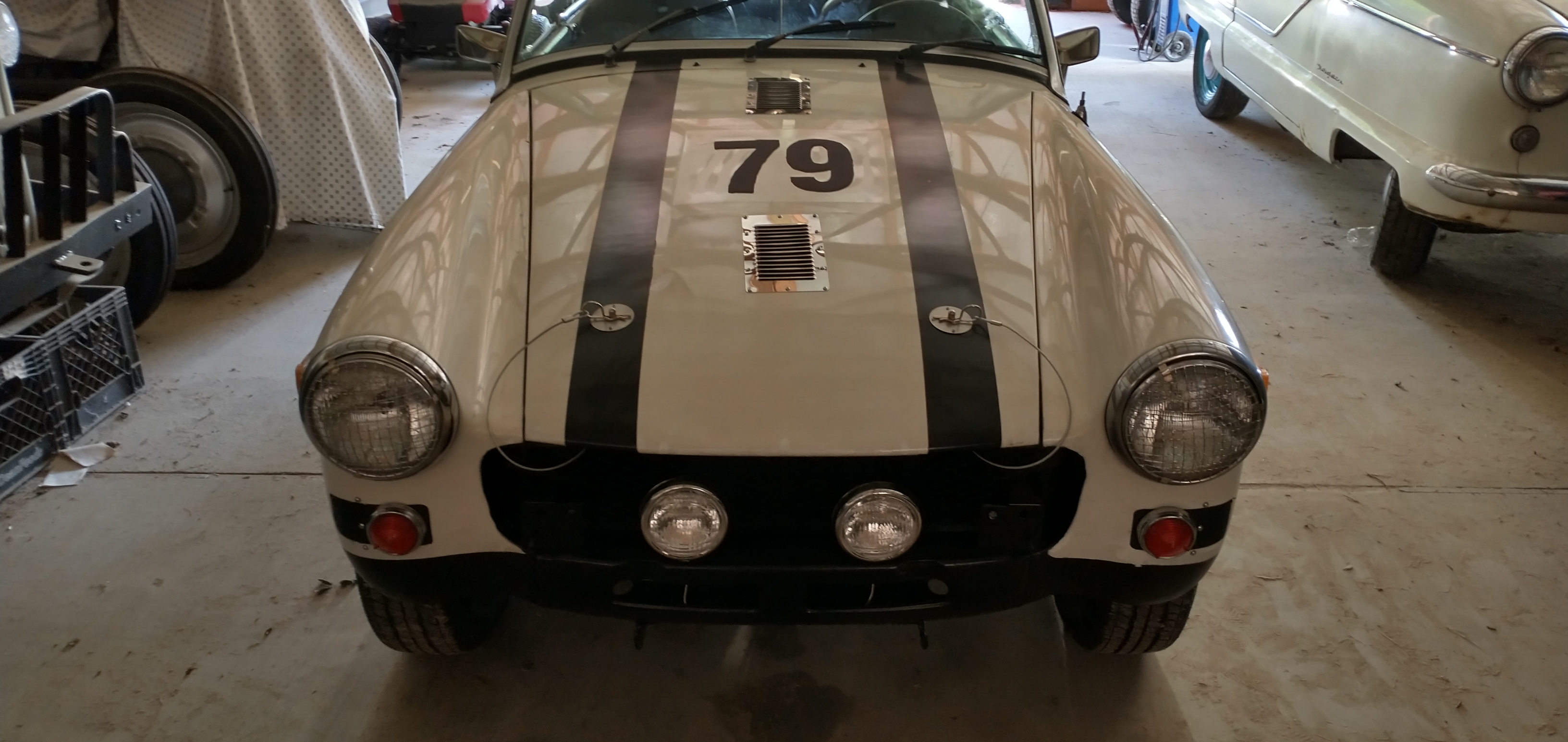

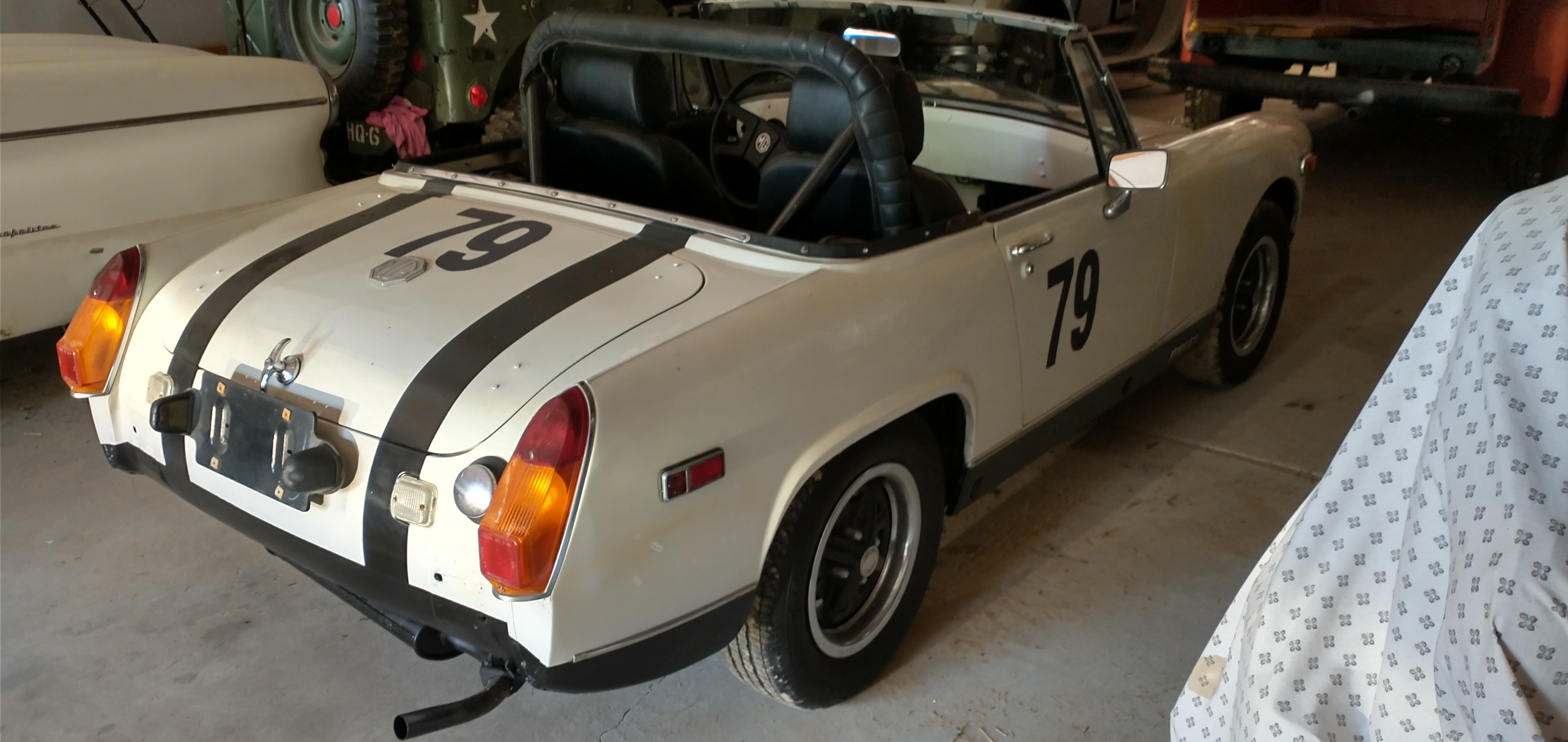

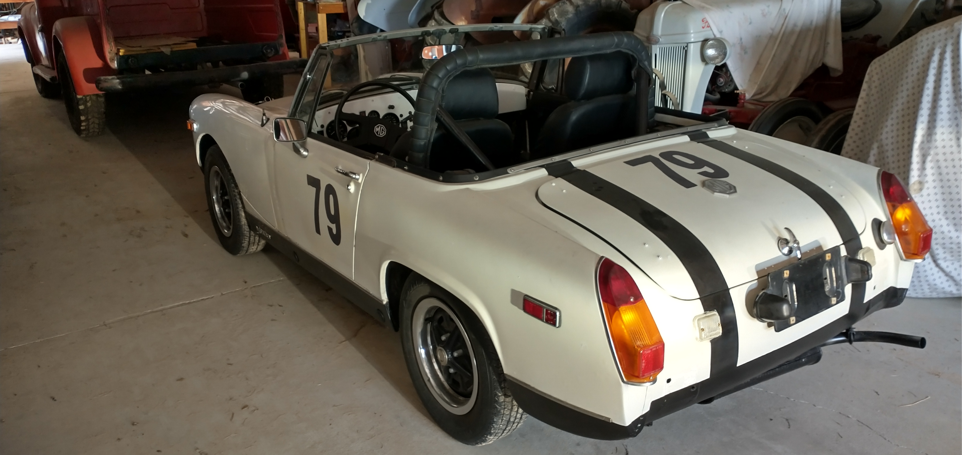

I am not racing it, I just drive fast on the Farm to Market roads. It has a sway bar, is that the same?
looks great and, yes, the same.
