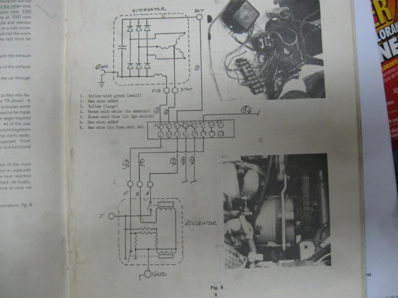

I found what looks like the conversion performed to this car with documentation included with it, namely a document titled "More BS about TR's" by Bob Schaller. I have attached an image of the cover, wiring diagram and instruction for conversion that a previous owner had accomplished with this post.
My questions:
1. There are only 2 wires attached to the alternator.
a. Large Yellow attached to the BAT terminal on the Alternator.
b. Small Yellow/Green attached to the FIELD terminal on the Alternator.
The wiring diagram shows a wire from the STAT terminal on the Alternator to TB2. It's not connected to anything. This wire does not exist. I suspect there is an error in the wiring diagram or the instructions?

Wow, talk about a blast from the past. I did that same conversion (on my own, not from Bob's instructions) some 30 years ago. But I followed the Ford factory wiring (even using a wiring harness from a car in the junkyard), while it appears that Bob has modified the circuit a bit.
Normally, the S terminal on the regulator would connect to the Stator terminal on the alternator. This provides a signal to the regulator when the alternator is turning, so it "knows" to apply field current to the alternator. From what I've read, this was done out of concern that the field (aka rotor) in the alternator might overheat if current was applied for a long time with the alternator not turning. But Bob's diagram shows the S terminal wired to the ignition switch instead, so the regulator is active whenever the key is on. That replaces the wire from the Stator terminal.
Peering into my crystal ball (which is actually an old headlight bulb), I'd guess that Bob originally wired ala Ford, and discovered the same thing I did : the alternator would often not start working until the engine was revved annoyingly high. His solution was to rewire the S terminal to the ignition switch and abandon the wire to the Stator terminal. Mine was to add a resistor across the warning light on the dash. Anyway, that is my best guess as to why he showed the unused wire. His wiring should work (except for the part about the rotor overheating).
In short, I think the diagram and instructions are the way Bob intended.

Randall,
No worries on the thread jack. Great information. Thanks for confirming the wiring diagram is valid. This gives me a good starting point for troubleshooting. I love these old cars!!
