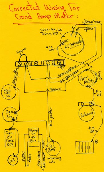

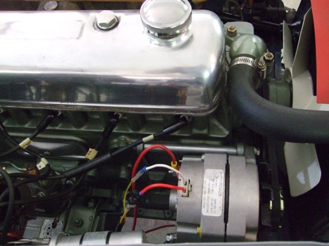

Rick - Can you show a picture of the wire(s) coming out of the alternator? I've read many places a separate wire is necessary to run the charge light.
If that's not true, would like to correct my understanding.

I checked my alternator and it's a three wire plug with two wires being used.

Here is a pic of a 3 wire alternator that allows the use of the charge indicator light and uses an GM AC Delco, 1993 or 94 era alternator. The bracketry is from Hendrix. The other pic is the wiring schematic to hook up the alternator using the yellow/green wire at your generator to make the charge light work. My drawing accidentally labeled the yellow/green as yellow/brown. In the pic of the alternator you can just barely make out that the yellow/green wire is attached to the inboard side of the two wire plug (which is a white wire on the plug) on the top of the alternator. In my opinion this is a far superior arrangement because it utilizes a common GM alternator that is available anywhere on the planet.
