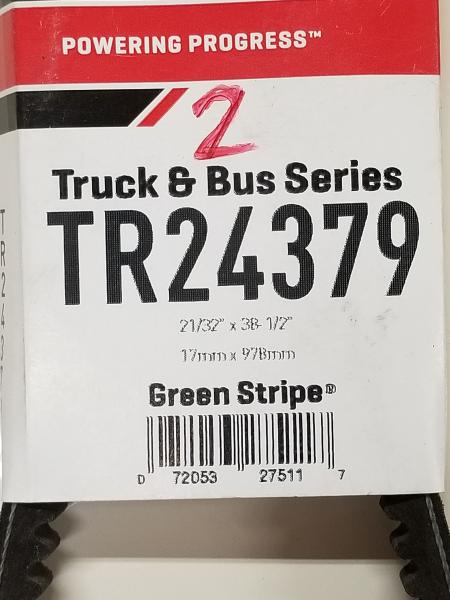

Here is the belt I used.
I have an alternator with a wide pulley, a new TRF water pump pulley and the original crank shaft pulley. All 3 pulleys are very slightly different widths. It is a tight fit to get it on but everything is driving on the flanges of the pulleys.
It can be removed without taking anything else off the car.
David
