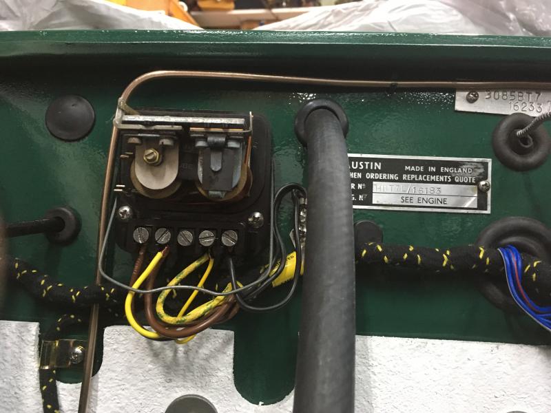

i have been reading posts and articles on the conversion. i want to use my voltage regulator so i wired today as i have seen in these articles. just wanted to make sure this looked right to you all. basically A1 terminal has the blue/brown wire; A terminal has the yellow wire from the alt and the two brown wires; the F terminal has no wires; the D terminal has the yellow green wire from the alt and the smaller yellow wire from the dash light; the E terminal has the black ground wire.
few questions:
do i need to run any other wires for the conversion? obviously i need to connect the ones to the alternator when i finally get one. i thought i read somewhere about getting a three wire alternator so wondered where the other wire went. not sure i saw anything about that.
this is a new wiring harness. are the wires in the harness heavy enough?
last, i read a lot about the wiring but not really how to place the pieces in the contacts so they can not connect. i used wire shrink to isolate the connections. i slipped one over the verticle bar on the right, isolating the front and the back of it. then i slipped another piece behind the contacts next to the coils. is this enough? anything else i need to do?

The big wire from the generator seems to be a 12 ga. Maybe not good enough at high speed. I ran a separate 10 ga from the alt to the battery cable mount on the solenoid. The big yellow if used, connects to the big brown wire from the solenoid. There are multiple threads here on how to connect these. Your pic may not be quite right.
Also see https://www.healey6.com

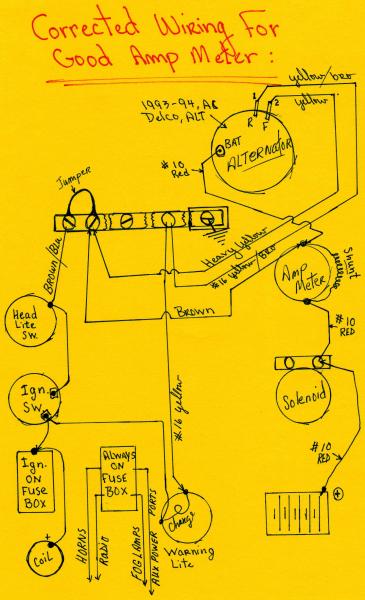

The terminal strip in my drawing is the layout of the screw terminals on the voltage regulator. Your wires should be connected exactly as are shown on my terminal strip. They are from the left, the Brown/Blue wire, the next terminal would have a large Brown with a large yellow wire, the 3rd screw from the left would have nothing on it, the fourth screw from the left would have the smaller yellow/ green wire (may drawing accidently shows it as a small yellow/brown) this fourth screw also has the small yellow wire from the ignition warning light on it. The last terminal on the right is just for a black ground wire.
Now you have to realize that on the left the Brown/Blue, the Brown and the larger yellow all have to be tied together, that is why i show a jumper on the two left most terminals on my drawing. I do not remember how the voltage regulator in internally connected so it is my opinion that all the internal connections to these voltage regulator screws must be cut away from the terminal screws. The only wires that are to be touching each other are the ones on my drawing. In your picture it appears that at the minimum you do not have the two left terminals tied together which would connect the Brown/Blue, the Brown and the Heavy Yellow.
Also, the wires in the original harness are not large enough for an alternator. It will electrically work but it is a hazard. I believe the largest wires in the original harness are #14. They may be #12 but even #12 is not large enough. This is why my preference is for a 3 wire alternator. Because the 3 wire alternator has a stand alone "BAT" terminal. this is the output to the battery. I run a #10 wire from the alternator "BAT" terminal to the "BAT" terminal at the solenoid. This then is the direct connection between the alternator and the Battery. Even a #10 could theoretically be too small but it is a good compromise in the it will carry between 30 and 40 amps. (yes I know it is not rated for 40 amps but it will carry it. and it will carry even more for short periods of time.) The original wire in the harness is rated for 20 amps max. Most Alternators are capable of putting out at a minimum of 60 or 65 amps. Some older ones may be only 45 amps. Anyway, this is not to be looked upon as that your car's equipment will never pull the rated amps of the alternator. The fact is that if your battery is in a low state of charge, or as such, is old, or just out of storage, etc, the alternator will put out up to its max rating to try to keep the battery up. This will easily overload the original wire in the harness. So put at least a # 10 wire from the alternator "Bat" terminal and the solenoid "BAT" terminal.

Say Drone Dog, You don't want to do any guessing here. I want to caution you to not mix and match different concepts here from other posters. I'm not faulting anyone, I just don't know what other types of alternators that others might have used. If you hook it up the way I showed it with the type of alternator I used I know it will work fine. as far as eliminating certain wires then make sure you do it with the same equipment that is used in that scheme. I also want to restate that internal connections in the original voltage regulator would change everything that I have on my drawing so if you do it as my drawing shows you must make sure that nothing else is connected to those wires except what I have shown.
Also, a #16 wire is not large enough for the jumper that I have shown. The Brown/Blue wire and the Brown wire have the heavest load of the whole harness on them. Make this wire at least a #14 and a #12 if possible.

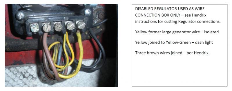

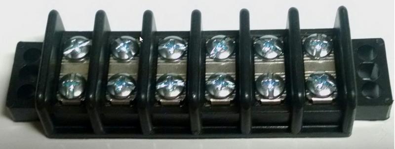

For the purpose of figuring this out, suggest buying a terminal block at the electrical/home store. Use that instead of the regulator. That way you're not destroying the reg.

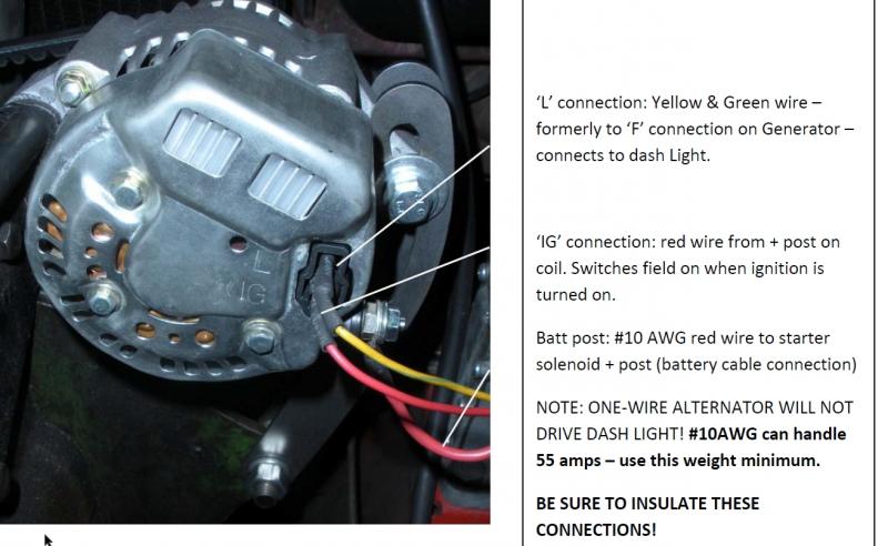

The pictures I've posted above directly reflect the Hendrix kit instructions. IMO these are the simplest way to hook up the alternator.
The 10ga wire direct to the solenoid is most effective because going to the connection block then jumping to the brown wires puts all the current at high speed through the brown wire from the block to the solenoid connection.
PS - those instructions also state you can use wire nuts to join the wires. This would suffice as a very temporary solution while you figured things out.
