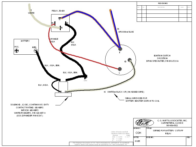

BLU_HLY
Member
If you care to shut off your battery without using the manual standard cut-off , you never need to open the boot to completely shut it off.
Sometimes the boot is so full of baggage that it becomes an effort to reach the manual cut-off switch especially for the 100's .
As a safety factor ,if you had an electrical malfunction, you might not be able to reach the manual cut-off in time.
Has anyone ever left their battery switch 'on' at night or in a dubious area - just forgetting ?
A relay and special ignition switch is easy to hook up.
