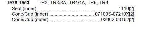

Also I'm looking for a good source for replacement wheel bearings. I'd like to use timkin, but they seem to be hard to find. Any recommendation for them or a quality substitute?

TRF sells Timkin bearings....

Looks like RockAuto still has them in Timken as well. Quite a bit cheaper than TRF, but harder to be sure you are ordering the right thing. They sell the cups & cones separately, so for the inner bearing you need 07100S cone plus 07210X cup. Outer I believe is 03062 cone plus 03162 cup.
In my opinion, National, NTN and SKF are also quality bearings. The main thing to watch out for (again IMO) are the "no name" bearings (including those that have been repackaged by County or Bap-Geon).
