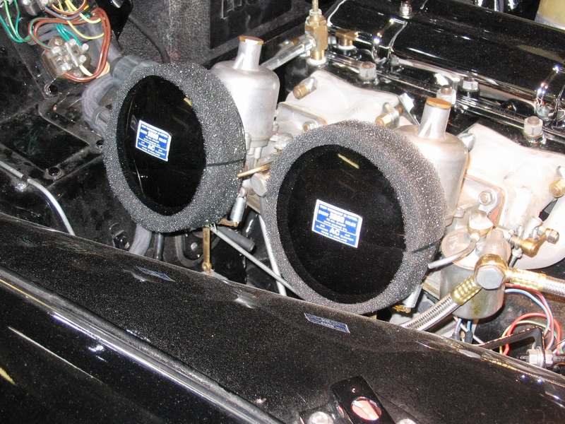

Can someone describe, or better yet provide a picture showing how the RHD spare steering column hole is blanked off on the TR3s and early TR3As? Everything I have is disassembled, and I haven't spotted it in the parts catalogs. I was thinking it would be a steel plate with a gasket, but maybe it is just a flat rubber plug?

Mine was a flat piece of rubber about 1/16" thick contoured to match the oval-looking steel support ring that goes over the rubber to close the hole. I made a new one just like the original one in 1990 and it has a hole about 3/8" diameter right in the center where the black rubber drain hose for the vent lid comes out - about 2-3 inches out from the rubber under carb #2.
Look below the air filter for carb #2 in back of the brass extender for the choke pull, you can see the bottom part of the steel plate and the rubber extending out around the plate - also the rubber hose coming through for the drain.

Hey Thanks Don! That also explains to me also where the scuttle drain goes, I knew about the battery box drain in the transmission tunnel cover, but not that other vent. I need to hunt and see if I still have that steel plate.

Nick - My TR3A came like that new in 1958. By 1987, when I dismantled everything for the full body-off restoration, I remember how the drain hose came through the center of the rubber plate because after 80,250 miles from new, that rubber was "limp" and bulging. It had lost its memory and was no longer flat. So I made the one you see there now after 18 more years and 100,000 miles.
BTW, S-T changed the skuttle design a bit later than mine (TS 27489 LO), maybe about TS 45000 or so where there is no longer any removable rectangular plate to cover the place where a right-hand drive TR would have the master cylinders. I believe it was also at this time that they may have done away with this plate and the rubber piece that we are talking about in this thread.
