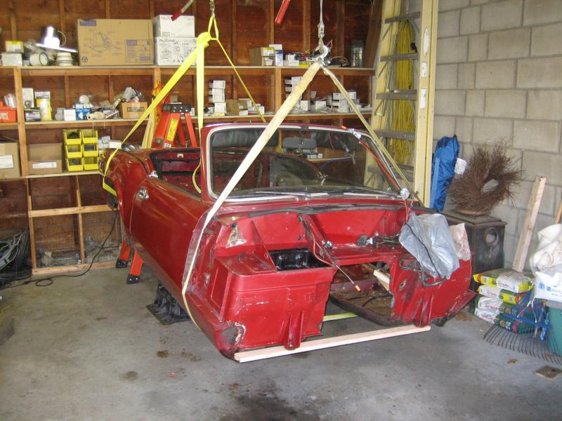

I had intended to do a minor restoration on my Spitfire. This is where it went. I found plenty to fix once it was off the frame. E68C6064-D081-4742-91E8-910CEC227A05.jpg
