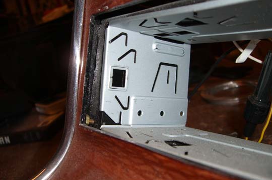

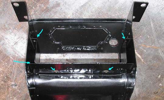

I’d bet anyone that has tackled this project has done something different. My head unit rotates down to expose a disk slot. I wanted to make sure that the door didn’t hit the lower lip of the console as it flipped open. The first photo shows how far back the radio cage is set behind the console face. I bent, then welded in some brackets that the cage would mount to. The welded portion encases the sides and bottom (second photo). The top bracket is screwed in. The bottom two blue arrows in photo #2 show drilled holes for the cage tangs to bend into, there are two more on the top bracket. The next photo shows the radio installed. Even with the cage set back behind the console, this radio still sticks out a smidge.
