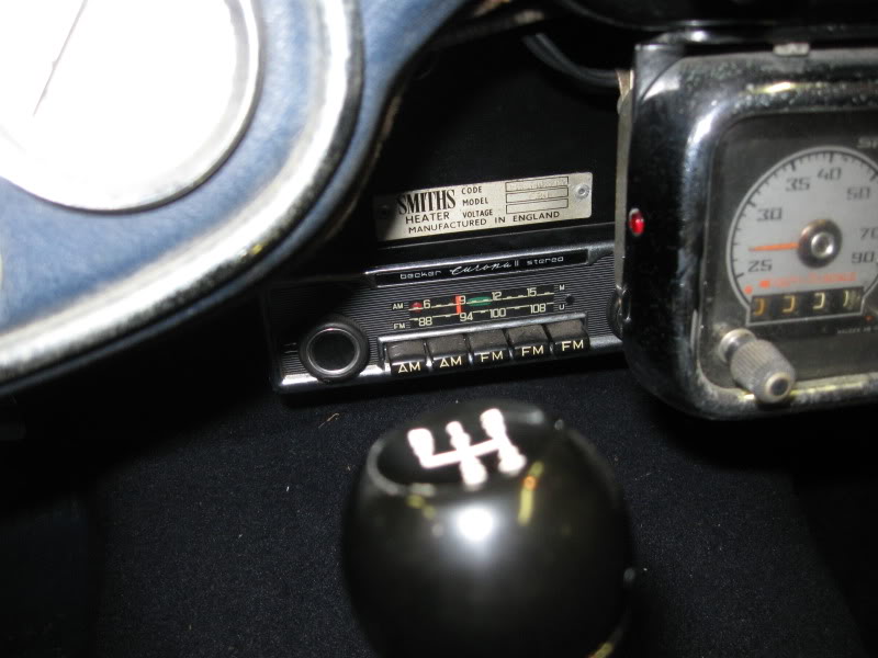

You could probably do something like this that would put the speakers nearby: https://newhillgarage.com/2011/11/12/article-49-upholstery-of-center-console/ You'll want some kind of amplifier if you want to have any hope of hearing any sound in a Healey. I have a Becker Europa Stereo II AM/FM that has an attached amp that looks appropriate and with an adapter cable that hooks up to the pin adapter in the rear allows me to play music through my iPhone.

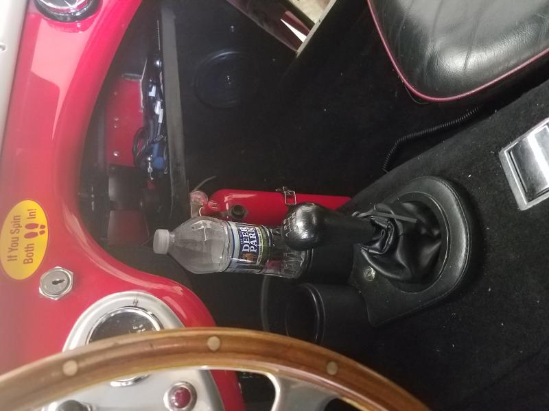

The attached pic somehow got inverted 90 degrees but in any case shows how the unit I linked to above fits on my 100. Because the Toyota box provides a center shift I am able to use this drink holder which is designed to sit on a fairly flat section of tunnel, and this would not work with side-shift cars.

For the cup holders I felt that the stow away holders under the dash would be in the way of the knees and everything else when they are deployed. Unfortunately in the Healey cup holders are in the way no matter where you put them. If there is no radio or heater the ones like Michael have look pretty appealing. But I decided to put mine to the rear of the shifter, centered on the tunnel between the seats. I made my own out of metal and first made them shallow then decided to give them some height to accommodate deeper cups. I covered it in vinyl and it just sets on the tunnel. Unfortunately I am not good at taking pics while I'm working and I don't have a pic of it in the car. But it works well. It works as a nice arm rest when there are no cups in it. You do have to be aware of the cups when shifting but on long day trips an easy shift with handy cups is most pleasant. See Pics.

Actually I do have a heater (see pic) though as I remember the unit in 6-cylinder cars is a lot larger.
I'd like to have a cup-holder mounted aft of the stick but I am afraid it would interfere with shifting much as you describe.
