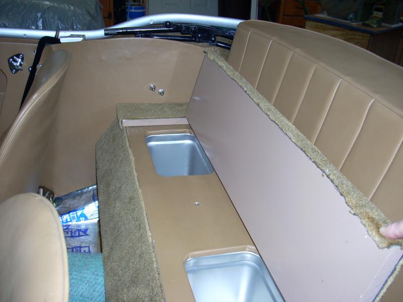

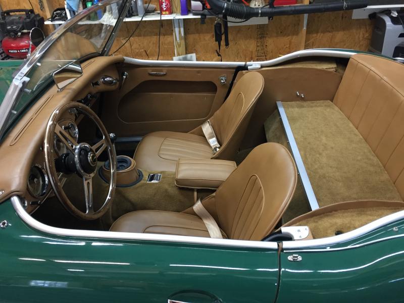

i have my heater but decided i did not need the back seats on my BT7. i bought a couple stainless steel pots and put them in the holes for the back seats. then built a cover for them. the whole unit is held in by one screw and can come out pretty easily. ALthough i don't think i have ever taken it out. the back seats are wrapped up on a shelf. DSCN0387.jpgIMG_2392.jpg
Hi Richard,

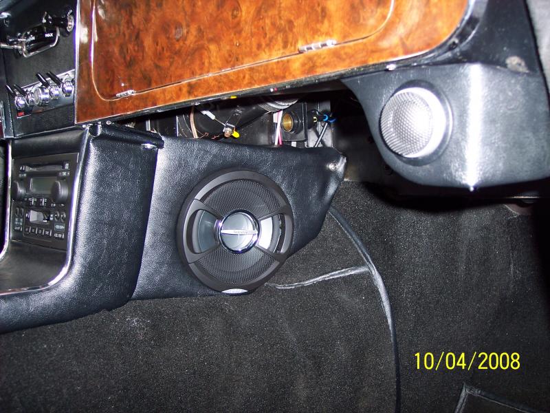

Although I do not have a solution to offer, I would suggest identifying the radio/sound system you would really like to have in the car and then select a unit, with its components, that meet your requirements. This would then have the extent of your installation requirements.
A while back in 2008, I went though this selection and when completed, fabricated a new replacement console (original is on the shelf), side mid range speaker mounts with tweeters on each end of the dash, and an amplifier and base installed in the boot.
Without your heater, you have quite a bit of real estate to create a sound system you can really enjoy while driving.
enjoy your Healey,
Ray(64BJ8P1)

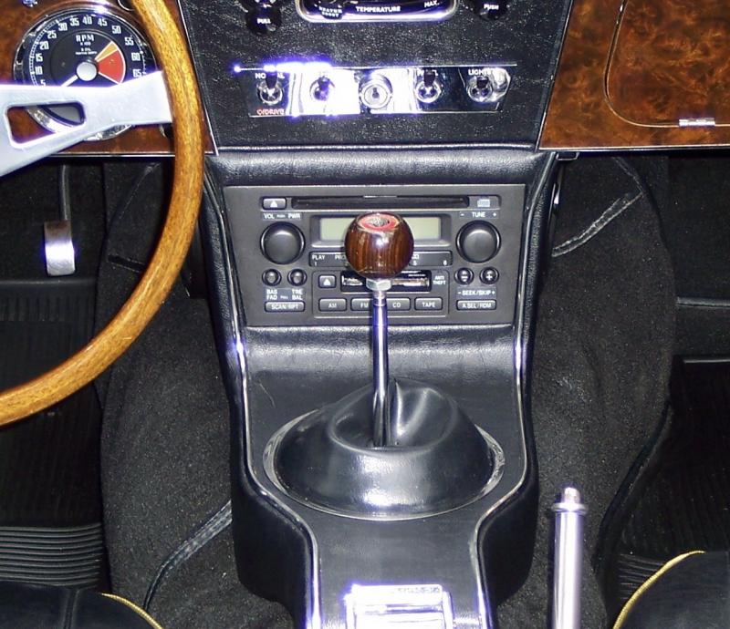

Work in progress... gauge panel for new EFI build. The ECU is behind the upper portion of the gauge panel. Much to do... gauge panel removes with 2 screws, one on each side... gauge wiring will be plugged for easy removal. Heater remains in place. Besides gauges, has 2 DC power ports. It will all be black wrinkle finished to have a "factory" look. The package tray will have the Lin Rose VW cupholder option.:tennis:
4 AH Center console 3 21 18 S50 7090.jpg5 AH Center Console 3 21 18 S50 7085.jpg6 AH Center Console build 3 21 18 S50 7096.jpg

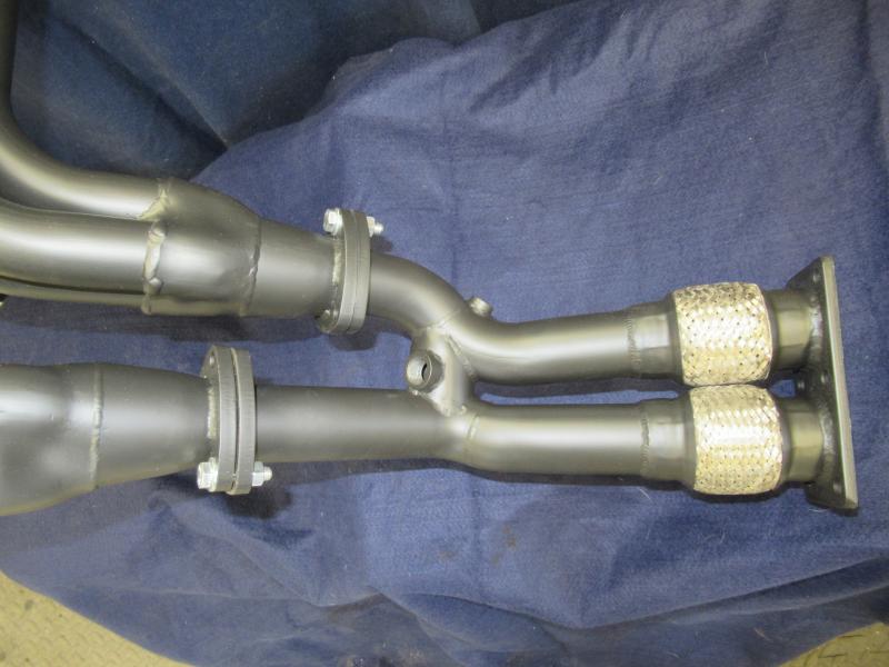

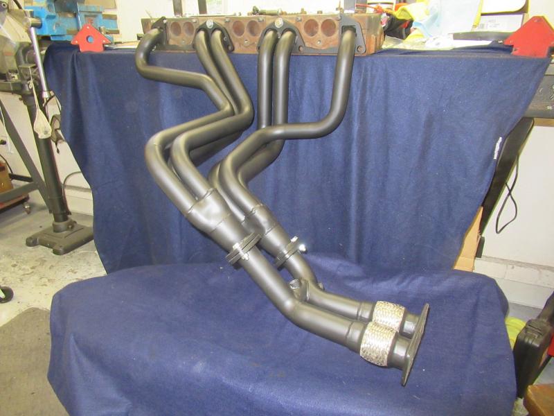

Steve, both the A/F (which is an Innovate gauge) and the EG gauge have their sensors reading from a center of an H pipe (see pic) so they read the blended readings from all 6 cylinders. On my last build I put separate bungs in both header groups (front 3 and back 3), and while it provides another level of detail during dyno tuning, I never saw an advantage in normal driving. So, this time I'm just presenting the driver with the blended readings. By the way, the Innovative gauge and Maximum Performance SW gauge didn't come with a bezel like the old style SW gauges so I had to get old style SW gauges and cut the bezel off it and adapt it to the newer gauges... sounds easy if you say it fast.:)
Completed Headers with junction section 2589 S50.jpgJunction with H bungs O2 and Temp 2591 S50.jpg

Beautiful job on the pipes!

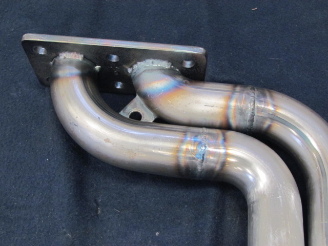

Whose headers are those?
Steve, those are modified Kirk headers. The #1 pipe on the original Kirk's is a slip on pipe that goes around the motor mount. I recontoured #1 pipe to go on the other side of the motor mount and it is solid mounted to the collector. I also cut off the collector end which was 2 1/2" flange and replaced it with a 1 3/4" collector flange... which matches up better to the rest of the exhaust. Then the whole thing was ceramic coated inside and out to reduce temperatures.... supposed to reduce temps. by 175 degrees. I like the Kirks because they have 1 1/2" primaries... many you see have 1 5/8" or bigger primaries... I'm told by smarter people than me that on a street engine you need to keep the exhaust velocities up so a smaller primary is better. I suspect the exception is if you are racer with continuous high rpm then bigger might be better.

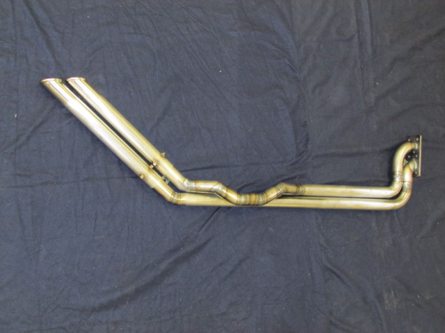

Steve, I'm using a stock muffler, but I weld flanges on front and back so I can … relatively... easily remove it. My exhaust is 1 1/2"... so 1/4" larger than stock. I also reroute it... pic attached. The rerouting is to accommodate the Udo Putzke rear shock kit.
Steve
