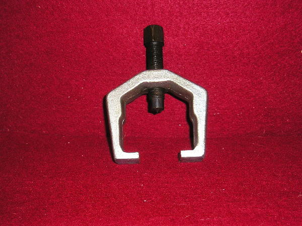

First I want to let you all know that I was able to take the steering box of a TR3 apart without removing the front apron. It was a bit of a challenge but (given my car at least) less work then removing and reinstalling the apron. What I did was remove the box as per the manual but of course it only goes as far forward as the apron. In the space between the normal box position and the apron I was able to rotate the box so as to remove the drop arm (thanks so much for the forum traveling pitman arm puller - it is ready for the next person in need), then rotate it again to remove the cover and then the rocker shaft assembly.

Congratulations on pulling a Houdini with that box -- well done.
I, for one, would like to see a picture of this puller if you have a chance before sending it to its next user. Thanks!

The Pitman arm puller looks like this. It has helped 4 of us TR3A owners to date. Tennesee to Minnesota to Quebec to Ontario. Next to West Virginia ?

As to the Houdini, it was not that hard, and I think for what I had to do I would not bother removing the apron even on a car that was "easy" to do so. I had to move the horizontal surface that the hand start crank support is attached to up a dew inches to move the steering box into that space. Once that was done it was a case of taking the puller to the drop arm (and it took some force on the puller bolt - in fact I used the impact wrench). Leave the big nut on there because when it let go it went with a bang. After that is is real simple case of turning to get access to what you need to get access to.
