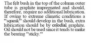

On my tr3 split column I want to replace the felt bush before putting it all back together whats the best lubrication? Would dry graphite work?
Twosheds
Oil worked O.K. for me.
TR3driver
Great Pumpkin - R.I.P
Actually, the workshop manual specifically warns against using oil.
Twosheds
I stand corrected yet again!
TR3driver
On the contrary, John, I think that is useful information.
I use MoS2 (aka moly) powder myself. But if I can't solve why the steering is still stiff on TS13571L, I may try using a UHMW or Delrin bush instead.
