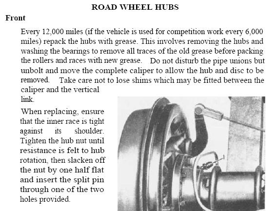

Semi Related to this thread:
My car has a bit of play in the front wheels.
i thought it was excessive so I checked the adjustment of the castellated nuts.
The Haynes manual says, snug them up then back off 1.5 to 2 flats.
I did this & they were still a bit loose.
Am I too fussy?
Do your front wheels have noticable play when you shake the wheels. You can do this on the ground. No need to jack it up to check.
Hoping for a response.
Thanks,
Bob
TR3driver
Great Pumpkin - R.I.P
Just one of the many mistakes in the Haynes manual. Later manuals from Triumph say to use 1/2 flat.
At 1/2 flat, you can just barely feel a tiny amount of play by shaking the top of the wheel in/out.
