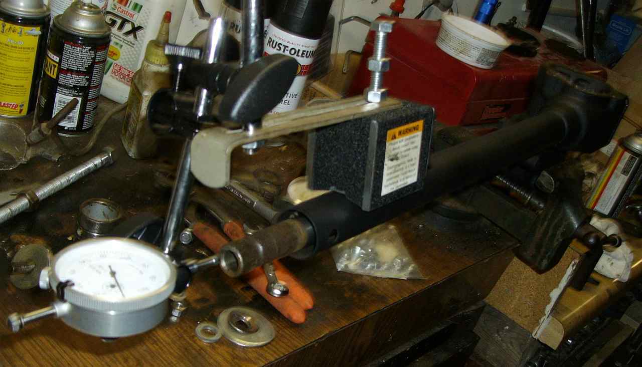

Oh and to check the end float, use a dial gauge on which end of the shaft? secure in the vice and set the dial up in a secure way and move or attempt to move it and measure the movement? I guess I don't rally get the process.
The shaft will move the same amount on either end, so it doesn't matter which side you put the dial indicator on. Whichever side is easier to measure, use it.
Put in too many shims so that the shaft moves, measure the end float, then remove that thickness of shims and your end float will be zero.

Here's a picture of the set-up I used to do mine (including the jerry-rigged magnetic base). The rocker shaft with peg is removed. Also note the rubber bushing at the end was removed to allow the shaft more free movement. Be sure to move the shaft only in and out in one direction, that is, don't let it rotate or become angled. I used a large flat bladed screw driver between the housing and the worm gear to 'wiggle' the shaft back and forth (adding or removing shims) until there was 0 end float.
When I was done, there was a little resistance felt during rotation because of the imperfections of the bearings. I hope this helps because I didn't really 'get it' until I 'did it'.
