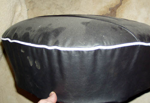

I bought new springs, padding kit from TRF and seat covers from Moss. I took it all to the local upholstery shop and they managed to butcher the seats in an afternoon. Check out the pictures. They told me the puckering would diminish with time. .I'm guessing they meant the half life of vinyl. Any thoughts on what they did wrong and how to fix the problem?
Also any thoughts on how to prevent myself from being such a sucker in the future?? /ubbthreads/images/graemlins/blush.gif

****, that's a bad piece of work. Judging by the crooked welting (white part), it looks like they should have pulled the cover from the side to side, then front to back, to straighten the welt cord before pulling the cover tight over the springs. Also looks like the padding over the springs is not even distributed to the edges of the springs (don't think the seats should look so rounded in the middle of the seat but should be more flat). Hope the seat backs look better.
You should be able to remove the bottom covers and redo them yourself. Once the cover is off, turn it inside out, place the padding evenly over the springs, then place the inside of the bottom seat facing on the spring/padding, press it down while you pull the sides of the seat bottom down over the springs. It will help to warm the seat cover with a blow dryer first to make it more pliable. Then once on loosely, adjust the welting to make it straight, flip the seat bottom over and press it down with your chest (or helpers set of hands) and fix the covering to the spring. Good luck!!!!!!!!
mcguijo
I believe the problem may be with the size of the new seat covers. I don't why I didn't look at this earlier. .I simply assumed something from TRF would fit correctly. The old seat covers are approx. 17.5" across at its widest point. My new seat covers are 19.5" and 20" across at their widest spots. I'm guessing the extra padding was used to fill the extra space under the new covers (and likewise what caused problems with the piping). Thoughts?
