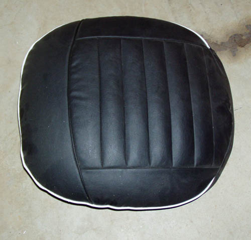

OK this is the time when I'm usually accussed of giving folks headaches on the forum. /ubbthreads/images/graemlins/rolleyes.gif However, I was told the opposite with the seats; early seat springs are more rectangular while later seat springs are more round. I guess the double/single piping is the sure way to tell. Either way, the forementioned replacement seats are double piping--replacing seats that were the same. In short, the replacements in my situation WERE made too large. Look at attached image. .the pattern of the replacement shown is exactly the same of the ones they are replacing..just about 2.5" wider.

... unless you're building for concours, it doesn't really matter. Either way your covers don't match the springs.

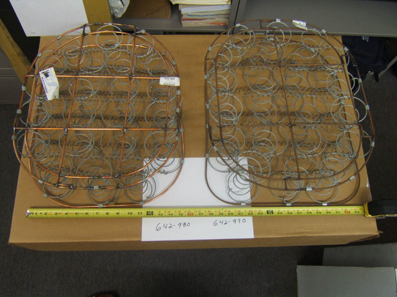

A fellow from Moss Motors sent me a picture of these springs for TR's seats. The spring on the right is for TR3 thru TS22013 (note more rectangle). The spring on the left is for later model TRs (note more circular). You'll note there are also other subtle differences in the two springs.
There also seems to be a design difference in the seat vinyl design between the early and late seat bottom (I couldn't find any pictures but could tell in my moss motors catalogue). I assume the change in seat vinyl design came about at the same time the springs changed (but am guessing).
Either way, I have the correct NEW seat springs for the correct NEW vinyl pattern (at least the part numbers match up on paper).

The following is from "The Original Triumph TR". "On the TR2/3 seats the upholstery 'panelling' of cushions and backrests ran 'front to back', whereas on TR3A seats it ran traversely". Strangely enough (or not) the "original" seat cushions I pulled off my TR had springs that more resembled the early model springs and covering that resembled the later "transverse" cushion. ..go figure.

...The old seat covers are approx. 17.5" across at its widest point. My new seat covers are 19.5" and 20" across at their widest spots. I'm guessing the extra padding was used to fill the extra space under the new covers (and likewise what caused problems with the piping). Thoughts?
[/ QUOTE ]
My '59 measures 18" across the seats at the widest point. I agree a wider cover (20") would have to take up the excess width somewhere. That high crown they put in your seats looks like where it went. Mine also has the rounded seat bottom.
