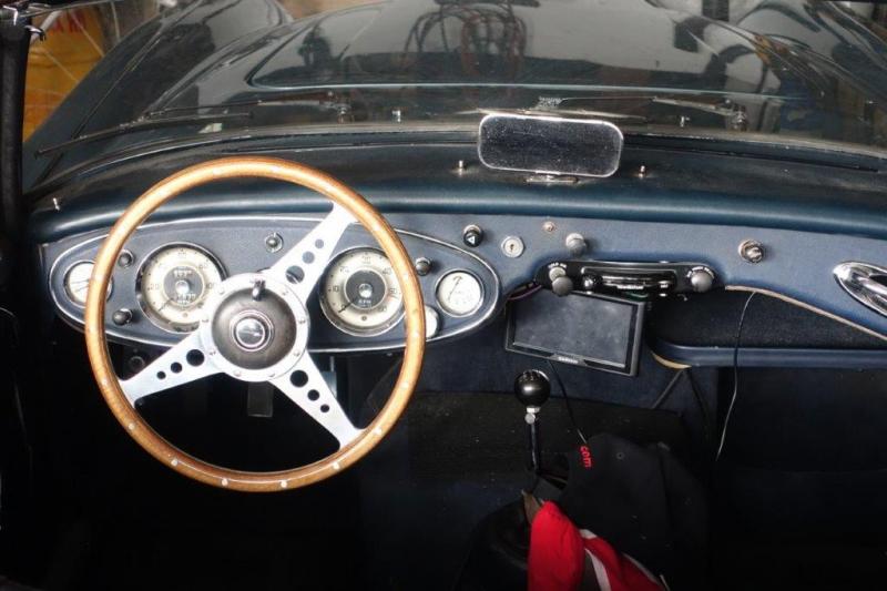

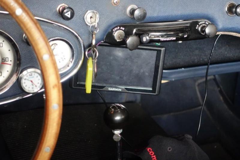

I've previously tried resting a Garmin GPS on the transmission cover, etc. etc., but believe that we've got a decent system working now.
Buddy Jeff pointed out that the rubber vaccum windshield mount at the base of the GPS could be removed by knocking out a pin; then he mixed up a batch of JB Weld and bedded 3 (1/2? maybe 5/8" diameter? can't remember) rare earth magnets into the base, and it now mounts to the steel heater box - see photos.
It's far enough under the dash that it gets some shielding from the sun, but also far enough back to be readable. If necessary, I can use my hand to provide some shade.
The keys are a bit of a distraction the way it's set up right now, but all I really want is to be able to read the GPS speed (we have the Toyota 5 speed but it's set up for a 3.54 ratio and ours is a 3.91, plus I'm really not sure how reliably accurate the Healey speedo is).
We've got a bit of flexibility in where to position the base on the heater box, plus the pivot arm on the GPS allows some additional fine tuning.
The first photo is from the rear of the car showing overall positioning; the second approximates what the driver sees.
Also - JB Weld advertises that it contains steel, and it surely does: the liquid mix moved around in reaction to the magnetic fields of the magnets.
Doug

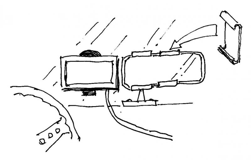

I made a clip (from 1" x 1/16" aluminum strip) to hold the mirror frame together and slid the mirror to the right, allowing the Garmin to be suction-cup-mounted on the windshield to the left of the mirror.

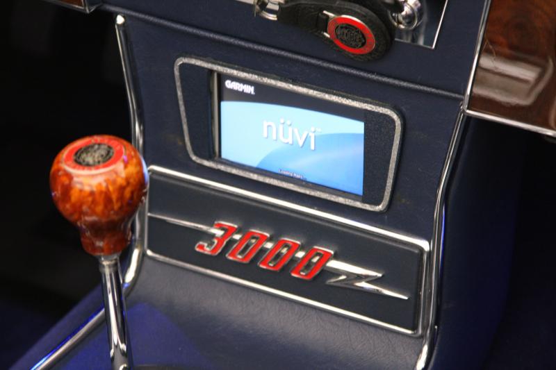

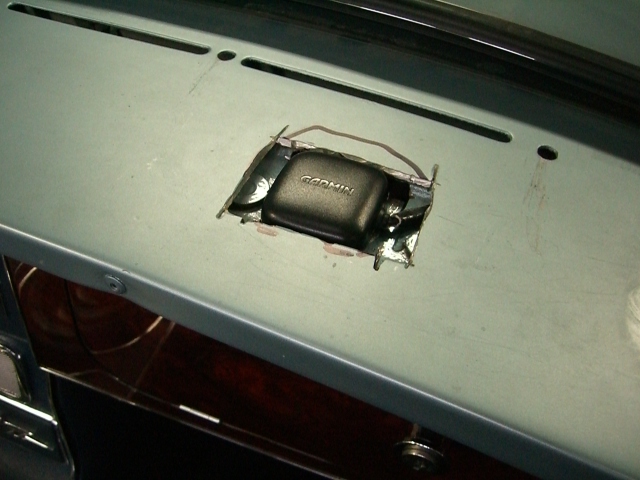

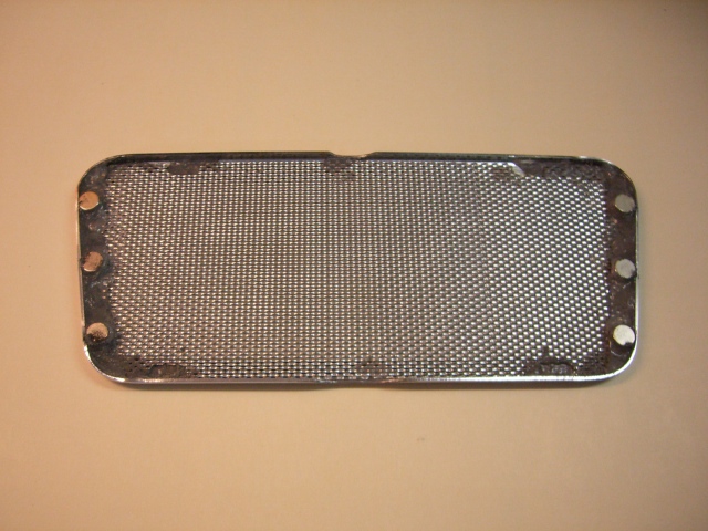

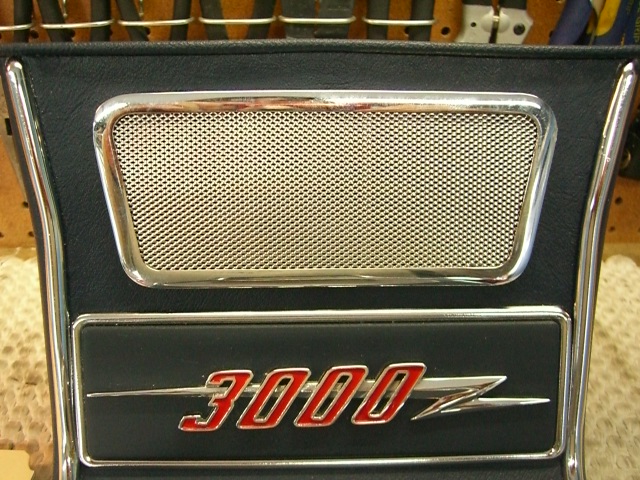

Nice to see others installing Nav's in Healey's. Here's how I hid my Garmin in my BJ8. Antenna is under wooden dash cover.
Antenna in top of dash 14.jpegAH photos Sonnen 01.12.09 040.jpgBack of grill with magnets 12.jpegFront with Screen on 13.jpeg
