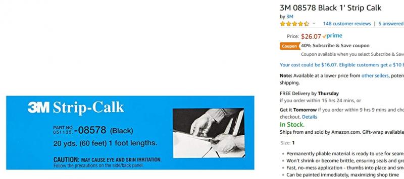

i found on the new grommets there was still a small gap around the cable or whatever. i used some rope caulk, which does not harden, on the inside squeezed to the cable/wires up to the grommet so there was no light coming thru. if your grommets look ok, you might even be able to do this without putting new ones in. the caulk does not show and it stays in place.
