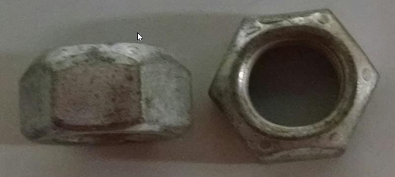

I'm in the process of installing my brake rotors to the front hubs (later 5 lug hubs). My hubs have studs that are installed from the front of the hub with nuts on the backside. Should there be washers under the nuts? The Moss diagram only shows the stud with a lock nut, no washer?

A locknut holds better than a spring (split) lockwasher. Plain washers are only necessary where you need to reinforce thin, i.e. sheet, metal.
I like the all-metal oval type, grade 8. I've been told these are the kind NASA uses:
