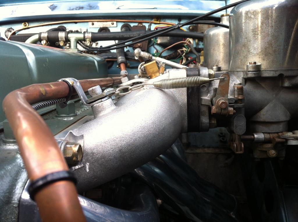

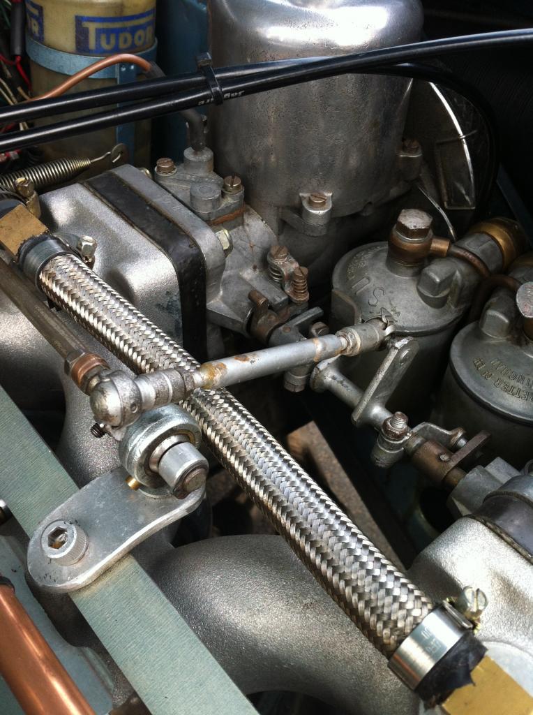

Hey John

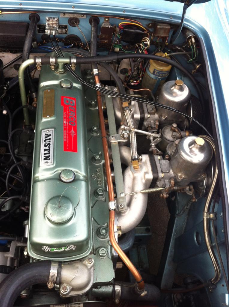

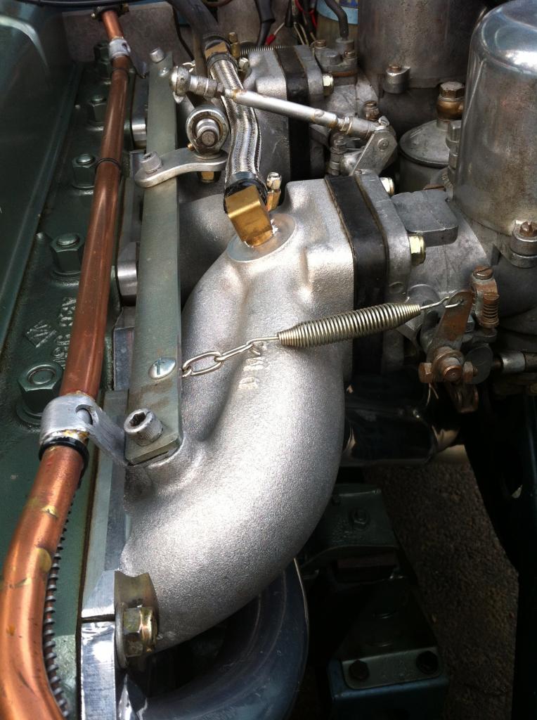

Here are a couple of shots of the DMD inlet manifold. The throttle linkage was made up by the guy (Ian Stewart) who rebuilt the engine. The only thing is that you need fuel bowls that sit flat - these were off something like a Jag - as the carbies now sit flat rather than angled up.
