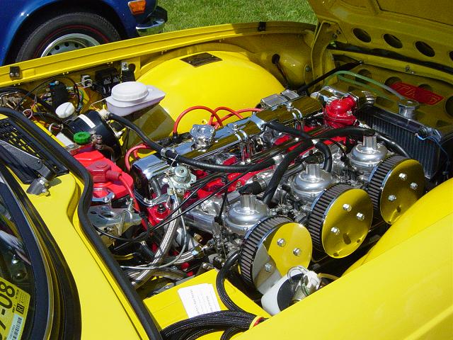

I bought my car with dual Webers. I replaced the two Webers with three 175 Strombergs. I have them running just fine now but a little rich. The gas mileage is surprisingly very good highway cruising. I don't care much about the around town mileage.
Performance? Well, I have done so much to the motor that I can't give you a good comparison with a stock conversion. I am told since doing this that the HP is accomplished by increasing the compression. My motor program consisted of balancing all rotating components, head work now 10.0:1 compression, GP2 cam and lots of other stuff.
This is the finish product. Go to the link below to see the components list.
