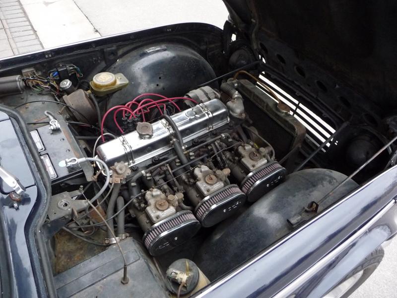

Here is a "before" pic of mine....you can see how close the front filter is...

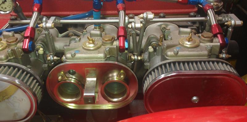

Finally got around to getting a couple of pictures of the K&N stubby ram stacks. There might, just might, be a bit more room at the inner fender on the TR6 compared to the TR250, but not by much. But like M_Pied_Lourd said earlier, it's still an offset screwdriver operation to get the filter cover off.

M_Pied_Lourd
Looks great. It does look like you have a bit more room at the front. Where did you buy your stubby stacks from and what size are they?

Tybalt
Cheers
Tush
I bought mine from APT under their part number WSS4016 stated as 16mm tall for the ram stack by APT, overall length is 53mm per K&N. They're pricey, but compared to prices I've seen getting them direct from K&N (K&N # 85-5042A) or places like JEGS or Summit, the price is pretty good. K&N sources then out of the UK from what I understand and are supplying aluminum ones these days. Mine are stainless steel.

If your filters are the K&N filters for the 40DCOE you will need to open them up a bit to install the ram stacks. If you happen to have 45DCOE filters, then you do not need to open up the filters. If you look at the illustration on the APT link, you will see a lip below the bell of the ram stack where the little clips ride to hold the ram stacks in place. That lip will not clear the standard K&N 40DCOE filter base. I set the ram stack lip against the bores of the filter base for each carb, marked them off with a Sharpie and then went after the filter bases with a die grinder using the ink marks as my guide and checking the work in progress against a ram stack periodically. It was a bit tedious but much cheaper than going out and buying a new set of filters just to get a slightly larger bore size in the filter base.
