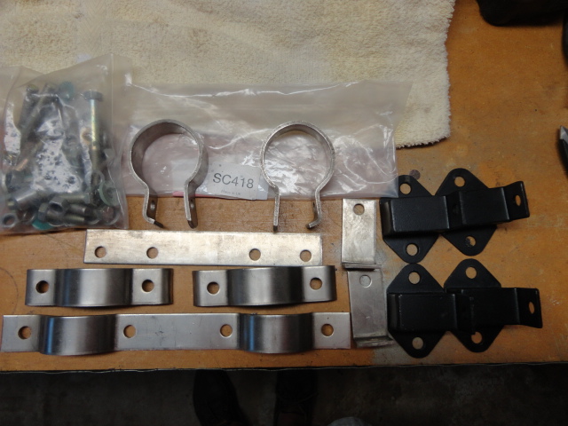

Patrick67BJ8
I was not aware that bell made an exhaust system for a healey

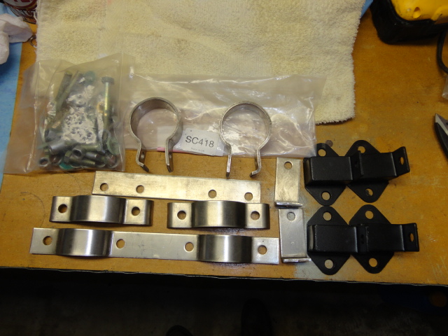

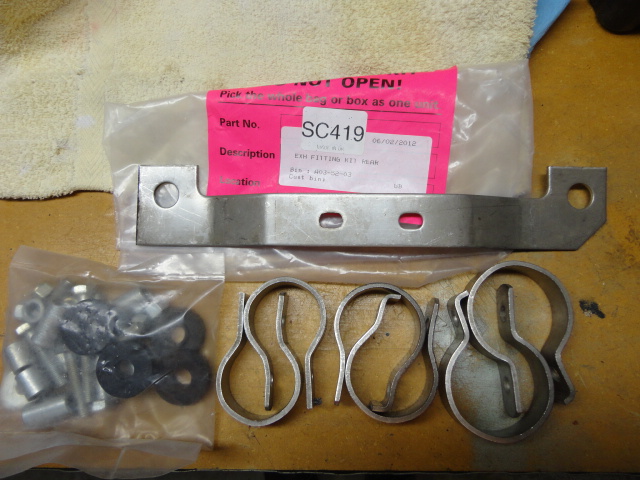

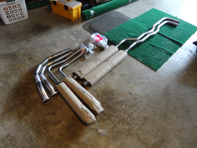

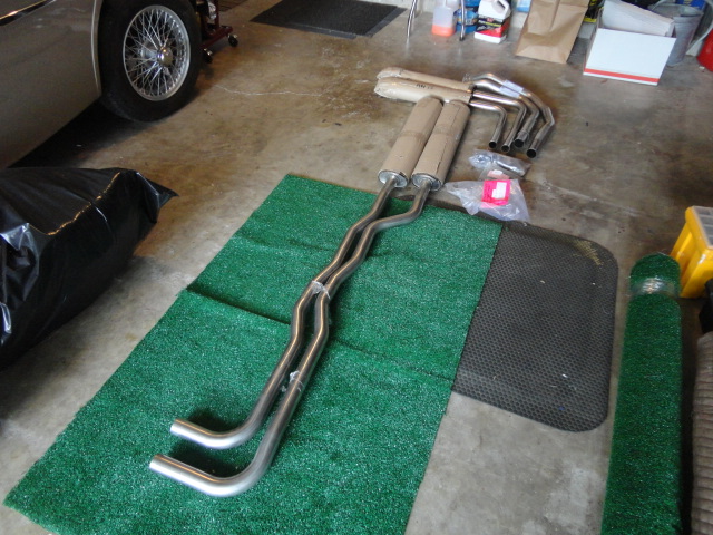

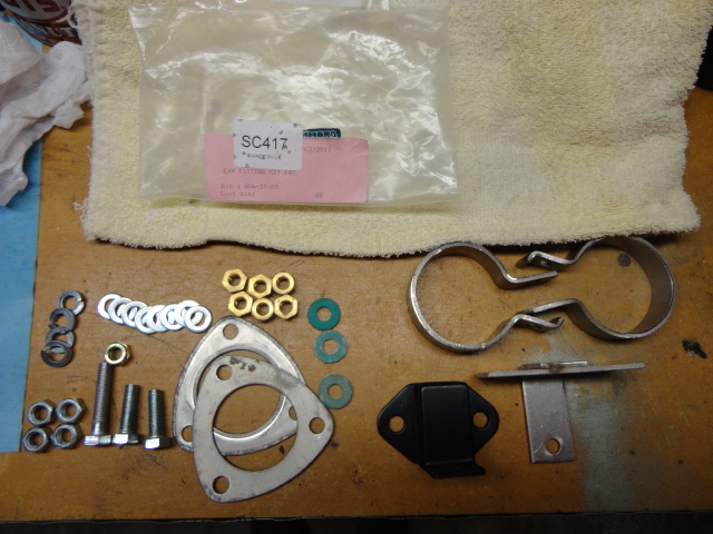

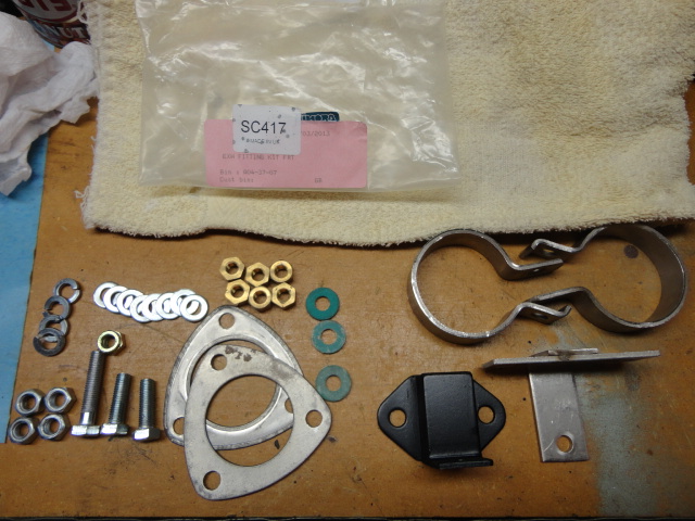

I purchased a Bell system for my BJ8. Very complete mounting kits come with it. PM me for source.
