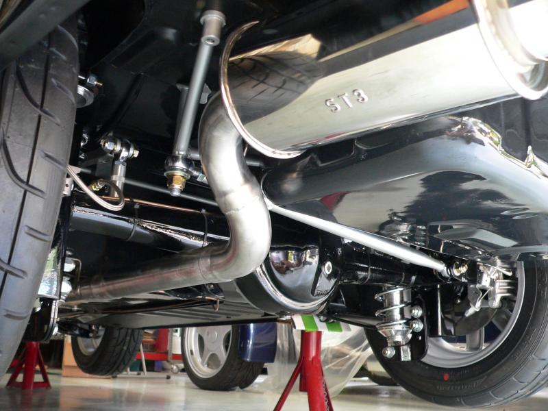

Fabricated mine out of 304 stainless. The orbit around Panhard was tight, needed a muffler that could fit up close to floor while sitting parallel to floor.

Blue Max - that photo is incredible! I went back to the 'thoughtful upgrades' thread just to get a list of what I was looking at. Did you fabricate the muffler as well?
BlueMax

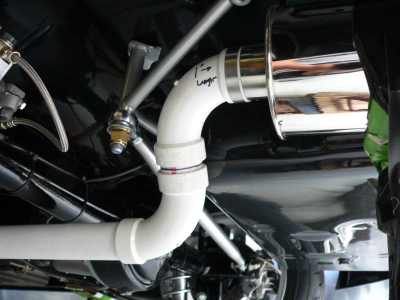

Thanks! I took measurements of the orbit where the muffler would fit. Then started shopping muffler suppliers until I found one that was stainless that would fit the orbit. I then set it in place and prototype up to the muffler in PVC tubing, after that I made everything in 304 stainless.
