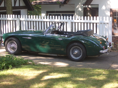

I am wanting to do something with the exhaust system on my BJ8. The front pipes down from the manifold are original, rusty and the flex portion of one of them has split in half. The PO had replaced from there all the way back with a mild steel system that is a bit tired, but no holes or big problems. I am thinking of perhaps replacing the entire system with a Bell stainless steel system. The other end of the spectrum would be to just replace the front pipes with new mild steel. Another option would be to cut out the flex portion of the existing front pipes and replace with the JC Whitney couplers previously discussed on this forum. I am also wondering if I could paint the existing pipes and mufflers (either replacing the front pipes or using the couplers) flat black? I don't like the way the exhaust looks from the side view of the car (see attachment) - kind of junky looking and maybe if it were black it would be a little less noticeable? Any thoughts, suggestions or opinions are welcome! Thanks!

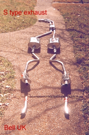

I don't know about Healey exhaust systems or even what the h*** I'm doing here, but I installed a Bell Stainless system in my '65 Jaguar S type hoping to quiet it down to the silence of my 1984 XJ-6 and the result was no difference, almost as loud as the old original system which was falling apart anyway, but nicer sounding, more throaty, sporty, and "controlled". I had heard that stainless steel systems sound different but I no longer believe that theory. The set came with every piece of hardware and rubbers needed, every part (pipes and mufflers and resonators) polished to a mirror show finish, AND the fit was better than perfect, like someone took the time to measure correctly. Whole lotta love in this set. I am sold on Bell ss exhaust systems. To say it is a "quality" system, it's just not enough. The only problem is: Who's going to see it? BTW, I installed it myself using Permatex Muffler Sealer in every union, the Manual says to use "Firegum" sealer but I could not get it in the USA.

Exotexs
John, I did my homework by researching Falcon, Dick Ames SS Exhausts, and another SS exhaust business in Canada whose name I forget, for my '65 Jaguar S type exhaust system;
the difference was that the Falcon, Dick Ames, and the Canadian\UK systems had more sections to clamp together than the Bell system, based on the drawings that I got from each company. The reason? they cut the long pipes in half for "shipping convenience", but that means more clamping and more places for leaks as the system ages. I wanted a replacement system that was identical to the factory system, only Bell duplicated the original system.
Worse: the hardware kit in the Falcon/Dick Ames and the Canadian\UK company's systems was OPTIONAL, (brackets, hangers, rubbers, clamps), and the Bell kit included everything in the price.
AND the other three companies would not guarantee that the mufflers would arrive dent-free, in fact they told me they were normally dented and scratched. hahaaa! My Bell system arrived very nicely packed, each part individually wrapped and OK'd by an inspector I assume, and not a dent or ding was found. The price for the Bell system (delivery and all hardware included) was also the best price of all = $740.00 for a twin system with 5 mufflers and 6 correctly mandrel-bent pipes. The 8 "u" clamps included are also stainless but I did not use them, I ordered polished stainless steel Band clamps from Burns Stainless, who makes racing exhaust clamps. "U" clamps distort/crimp the pipes when tightened, creating exhaust pressure bottlenecks.
I got my Bell system from SNG Barratts USA, a Jaguar supplier. Bell does not sell direct in the USA, you have to order from a USA Healy supplier who offers Bell. Correct me if I'm wrong, but I think Falcon is from Italy???, so if Falcon is anything like the italian Ansa and Abarth exhausts of the 1970's, they start to rust inmediately after installation. Been there done that. (check the attached image of a water decal that I still have from an exhaust system that I installed in my '69 MG-B back in 1974, which was worse than the original system).
I think that Bell offers Mild Steel systems too, so stainless is optional. I went with stainless because that's what my S type still had from the original factory system that had not been replaced.
I hope this info. helps, otherwise, it's your car and you decide.

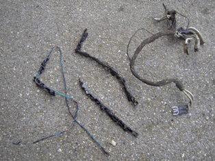

hey, I want to include a photo too.
I didn't have a pic of my exhaust, so I used my fried overdrive harness. It looks a lot like it, except it's not stainless steel, shiney or the same shape.

Velox
[ QUOTE ]
[/ QUOTE ]
SHG, thanks /ubbthreads/images/graemlins/lol.gif I had one of "those days" and when I read your post then clicked your photo, I burst out laughing /ubbthreads/images/graemlins/crazyeyes.gif /ubbthreads/images/graemlins/crazyeyes.gif which of course had my wife ready to call 911
