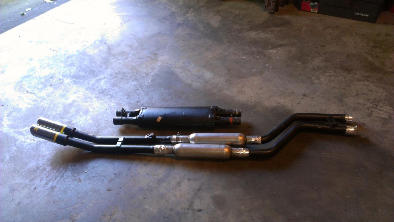

127.jpgi tried to do it with a monza exhaust and it just doesn't fit ,i even used earlier downpipes
Chris_Masucci
I don't know about the Bell or Monza, but I had a Falcon stainless BJ7 version on my BJ8 and it fit fine. Yes, I did have to fab up a simple offset bracket for the rear tailpipe and rear muffler mounts, but other than that it was fine. If I remember correctly the tailpipes fit between the frame rail and the rear axle spring mount with plenty of space.
