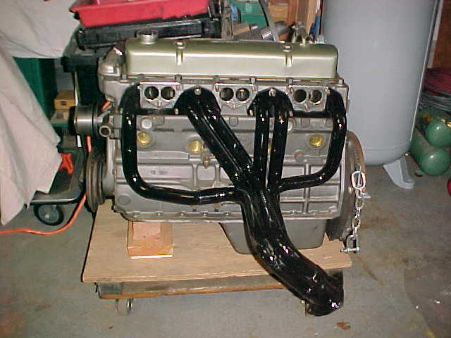

got my new "kirk" headers, very well built, came with pipe end transition tubes, end gaskets, nuts, bolts, and washers, only thing im not liking is that the pipes are proud of the flange face 3/16" not allowing a total flush fit against the head gasket, considering shaving pipes flush with flange, any sugs?.

Don't "shave" them, that's done deliberately. Those protruding tubes will ensure a positive seal against the head surface/gasket.
anthony7777 said:
randy, thanks, my bugeye nut friend capt bob said the same last night but ah..well hes a pilot. :laugh:
I can appreciate you wanting a 2nd opinion, I know a few pilots myself... :crazy:
