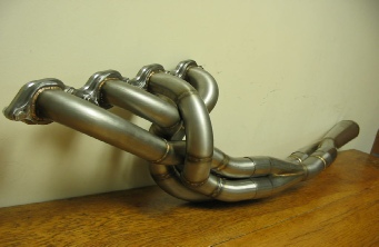

Yep! Those are just ballpark figures, Burns will tell you more. You want to match the port area (remember, calculate area of 1.5" which is 1.58" area (.040 wall tubing). A stock port is probably a bit smaller.. may want a 1 3/8" primary off the port. Make it square and let it transition to round, start at the top, then the sides, then the bottom.
Those first numbers are the primary. So step up at 12". You need the large bend radii to make those diameters work. The larger the bend, the more it can flow for a given diameter.
You want it as swoopy as possible like this, which is near impossible on a TR. Just try your best:
