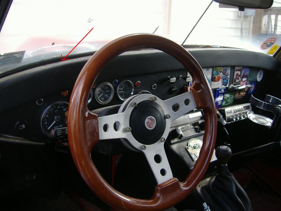

I am going to step into something that I will regret but I think that Drew is right that it is not a '65 but I am beginning to believe that it is a '73 or so (split bumpers).
With a common ruler, what diameter is the face of the speedo /tach? Or more easily, show us a picture of the dash.

not areal good photo
drooartz
That dash shot puts the car at '68 or later. Can't remember when the round arch cars came in ('72?) -- that would be the upper limit. Forgot to look it up last night. Split bumpers would make it '70 - '72 I think. More knowledgable folks than me will chime in, I'm sure.

You need to establish exactly what year the car is to start and then we can determine if it was originally a positive ground car and if so what to check for to see if it was converted to negative ground by a previous owner. Give us the first 4 didgets of the serial number located on the cowl behind the windshield and we can at least tell you what series it was to start with. If it's a GAN 4 or GAN 5 then it was most definitely a negative ground car from the factory.

Banjo steering wheel and padded dash - 68 or 69.

Chassis sounds like a '65 then. Isn't the one on the frame the "important one"? Engine number doesn't matter, be interesting to see what the dash plate says I guess. Could easily be compilation of years at this point, many are.
