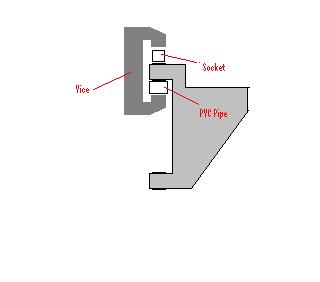

I used the "socket in the vice" method as well, but with a twist. I used a utility knife to cut the rubber lip around and edge of the training arm then cut a piece of PVC pipe to roughly resemble the profile of the side of the trailing arm OPPOSITE the side that I will be pressing the socket into. The theory being that I as press the rubber will be shoved into the center of the PVC pipe. I'm attaching a small pic that I made of my device. It was still a pain to do. It was hard to get everything lined up so it would push out. But I managed to do both training arms in one night using this method.

Ah, the pvc pipe acts as an offset, allowing the vice to push back against the trailing arm but allowing the bushing an escape route as you press from the other side. I don't have a vice, believe it or not, but how about a big C-clamp. I'll give it a try. Thanks
