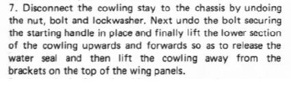

The Haynes manual, in describing radiator removal, does not mention removal of the apron.
That's odd, mine does (although they call it the "cowling"). Are you sure you didn't read the TR4 procedure by mistake?

FWIW, the Haynes section is almost word-for-word from the TR2/3 factory workshop manual. They do kind of make sense, if you know how to interpret them. For example, the "cowling stay to the chassis" refers to the two rods that help support the hand crank guide. And the "water seal" I believe is the rubber fender welt that was used on early TR2. Even without the welting, I find the apron comes off a lot easier if I pull it forward at the bottom first, just an inch or two, before pulling upwards.
