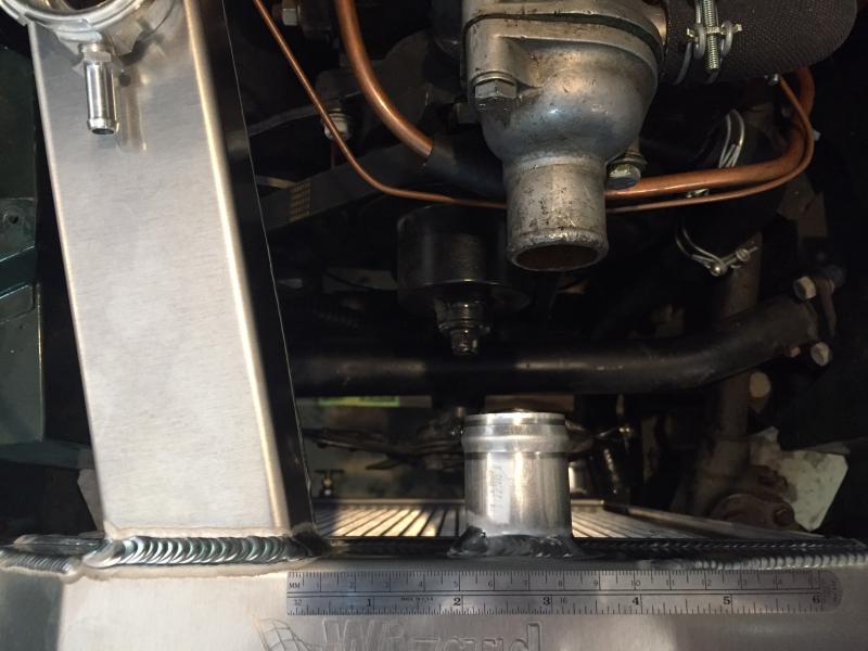

Reviving this discussion after a long time! Just popped a Wizard Cooling aluminum rad into my TR3A. Fits great EXCEPT the top pipe that connects via a short hose to the water pump isn't lining up; the opening on the radiator is about 3/8 inch closer to the filler neck than on my original radiator. I can force the accordion-style hose on to both ends,connecting the rad to the pump, but not sure this is a good idea. Any suggestions?

Seems like a rubber or metal shim under one side would cause the two hose pipes to line up pretty well. Or could enlarge the holes in the radiator bracket at bottom and slide it over. I'd just shim it so the offset on the accordion hose was reduced. I have the same radiator and a SPAL fan (thermo-controlled) and even in Sacramento's 105 degree days, she runs cool and without problems. I had to change the thermostat to a hotter thermostat for winter. The car was running too cold with this setup.

You adjust the location of the top of the radiator with the upper struts on either side of the upper radiator tank. That is, assuming there is any adjustment left.

Also on the"TR3 with the crank hole in the radiator, one had to shim the engine to get the radiator hole to match up with the crankshaft front nut. So there is another " adjustment " area -- shim the motor mounts-- that you could use. Another recommendation is to use one of the new silicon hoses in this location to hopefully withstand any extra flexing.

Well, I just have to say it is a shame if that much adjustment is needed to make the new radiator work. The radiator inlet should be offset to the left quite a bit - is it centered or just not far enough left to match the original design?

Geo, I have two of them in two TR4s. I don't have that much difference. So I was suggesting that maybe something else is "off". After all most of our cars have been in the hands of people that have done all sorts of unspeakable things to the cars.
