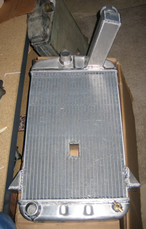

I had a friend of mine who owns a radiator shop fabricate an AL radiator for my TR3A. I gave him an original for specs. Unforunately, we miscommunicated and he ended up putting the crank hole into the radiator. I suspect it works fine but I won't be using it. You think anyone would have an interest in this?

[ QUOTE ]
[/ QUOTE ]
Your friend did a nice job! That's a very good looking alu replica. A thin coat of black paint and it would be hard to tell from original, but would still give the improved cooling and lighter weight of aluminum.
Seems like an ideal solution for someone wanting highly original looks *with* the crank hole, but still wanting improved cooling. I don't know exact figures, but if the aluminum were, say, 15-20% more efficient with heat transfer, that would offset the 15-20% loss of efficiency due to the crank hole design (because it blocks 3 or 4 of the tubes in the rad).
Judging from the photo, the only things that don't appear stock are the drain petcock and TIG welds that are a bit heavier than soldering on the original.
