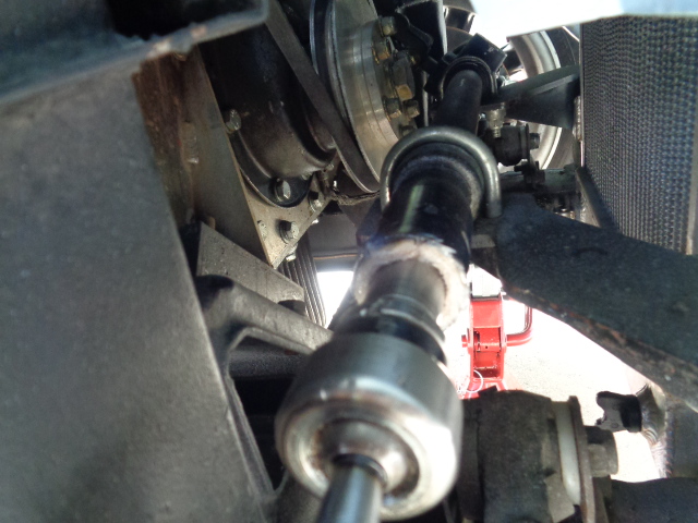

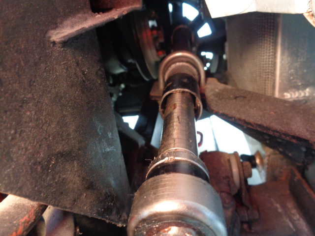

In the pics you can see the support tube of the rack with the tie rod passing up inside of it. It appears that there was a circular phenolic bushing at the end of the tube that kept the tie rod off the tube itself. I found that bushing in the grease that was at the end of the tube, in many small pieces. Not sure what broke it up, maybe it got a few cracks during installation when the tie rod was moved a bunch and mounted. Who knows..but it is destroyed and I cannot see any way to pass another one over the knuckle of the tie rod and tie rod end to get one back in place.
I have the right tie rod end off and have a pretty good view up into the tube....when hooked up and the steering wheel is turned the tie rod barely touches the tube when I bounce the front end very hard. I need to fabricate AND INSTALL a new bushing. Or make one from a bit of silicone as there is nothing the bushing does other than prevent contact between the tie rod and the tube. I have to have something flexible enough to pass over the tie rod knuckle and into place at the end of the tube. Then reinstall the boot, and the tie rod.

I have a new set of boots...they were never the issue. I tore one when breaking down the tie rod that had the failed bearing. And it was not a metal bearing but one I would describe as phenolic, a hard rubbery device. It was inserted in the end of the tube you see in the pics...it had deteriorated and the tie rod was banging into the tubular housing.
I could not remove the knuckle or the tie rod from the rack, all I could remove was the tie rod end/ball joint.
I could not slip anything over the end of the tube.
All I needed to do was construct something that isolated the end of the tbe from the tie rod.
I accomplished that today by using heavy watherstripping felt, three layers deep into the tube and epoxied into place.

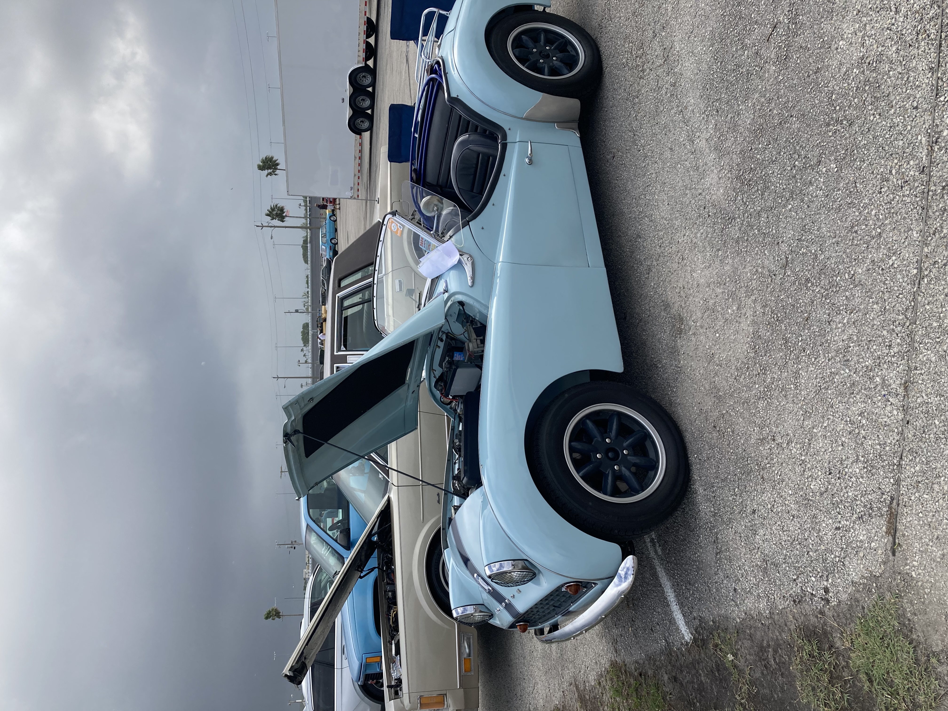

The car ran great today, we had a fanatastic time at the Daytona Speedway for the springtime Turkey Day run.
I had the only Triumph at the meet, with a lot of interest in the car. Chatted up the restoration all day long.
At the end of the day we all got to run our cars up onto the track. Since the banking is over 30 degrees inthe turns, it is impossible to venture up there unless at speed....we were only running 25-30 mph. Unfortunately, wife and I are not too keen on videos so will need to get one of the youngsters to get ours squared away....but I do have one of us entering in the tunnel and a pic of the car in the show car corral! And yes, we had a light rain bearing down on us as well...
