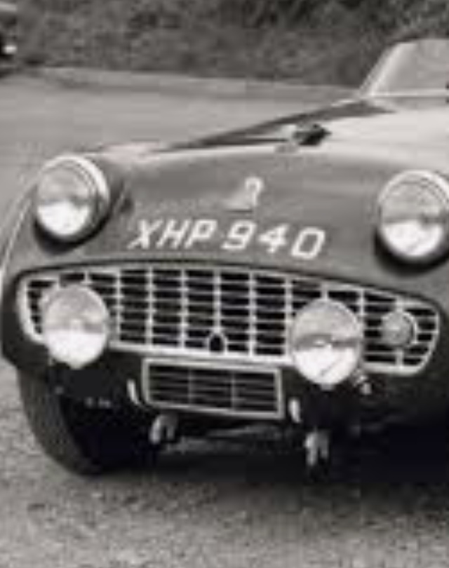

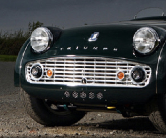

TR2/3/3A TR3 front air vents mounted under the grill...seen on race cars for better air flow to radiator.

Typically the under grill vents are to oil cooler that some mount under the rad mouth
These are typically DIY fabricated

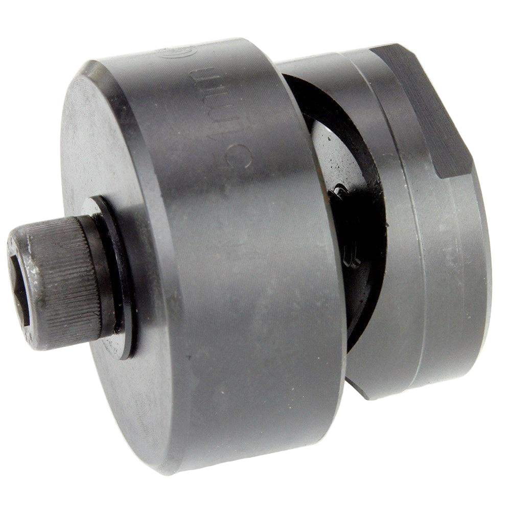

The round ones are via hole formers that give a tidy radius like this
