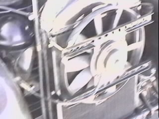

Running a bit above 185 won't hurt. Water needs to stay below 212 deg. F where the heat transfer coefficient changes when the water changes to steam. But a 25% antifreeze mix probably moves this up to 220 deg.F. And a 4 psi pressure rad cap will move the boiling point up to about 130 deg.F. So don't worry unless you are caught in traffic for more than 5 minutes when it may get to this temperature. That's when you need to have the electric fan. My fan is a 12" ducted Kenlowe fan from England pushing air through the rad.
I believe that when they needed to add the cross pipe for rigidity after the prototype TS-2000 (the first car shown with the rounded tail), they had to feather the pitch on the fan blades for it all to fit. This fan doesn't do much to pull air through the rad when you are idleing at 600 RPM.
